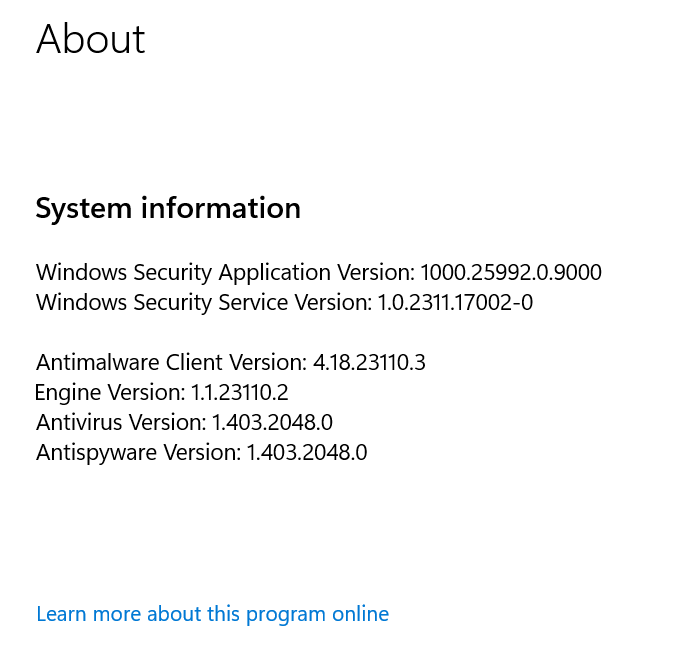

So, I have checked the Windows security versions : these are similar to those on your screenshot, except that the last digits for the anti-spyware and antivirus are different.
As to my question about the SecurityHealthSetup.exe and what it displays, it results from the fact that when I executed the program, the publisher is unknown - I was assuming it would be Microsoft Corp ?
Wondering if this is not sort of a security risk.
  1. The antivirus antispyware is higher because you took the screen shot after you got another update. If you try again later, it will be even higher.
  2. The message you got is the normal one when you open a .exe with administrator. It probably says unknow publisher because you copied it from another PC.
I think you are fine and now you have the latest updates of security.

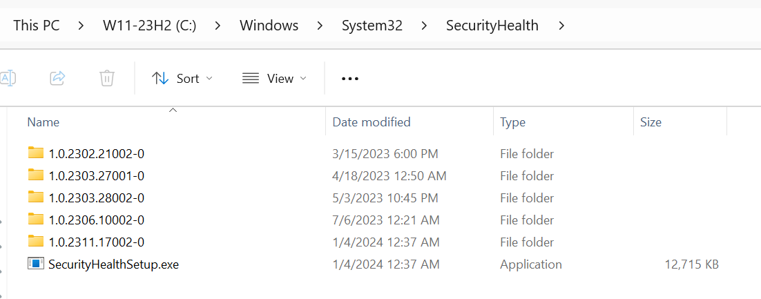

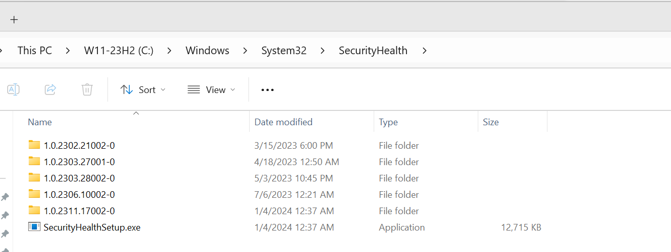

If you check C:\Windows\System32\SecurityHelath folder the updates should be now in there, probably none of the older ones that I have, just 2311 folder and the SecurityHealthSetup.exe. 😎

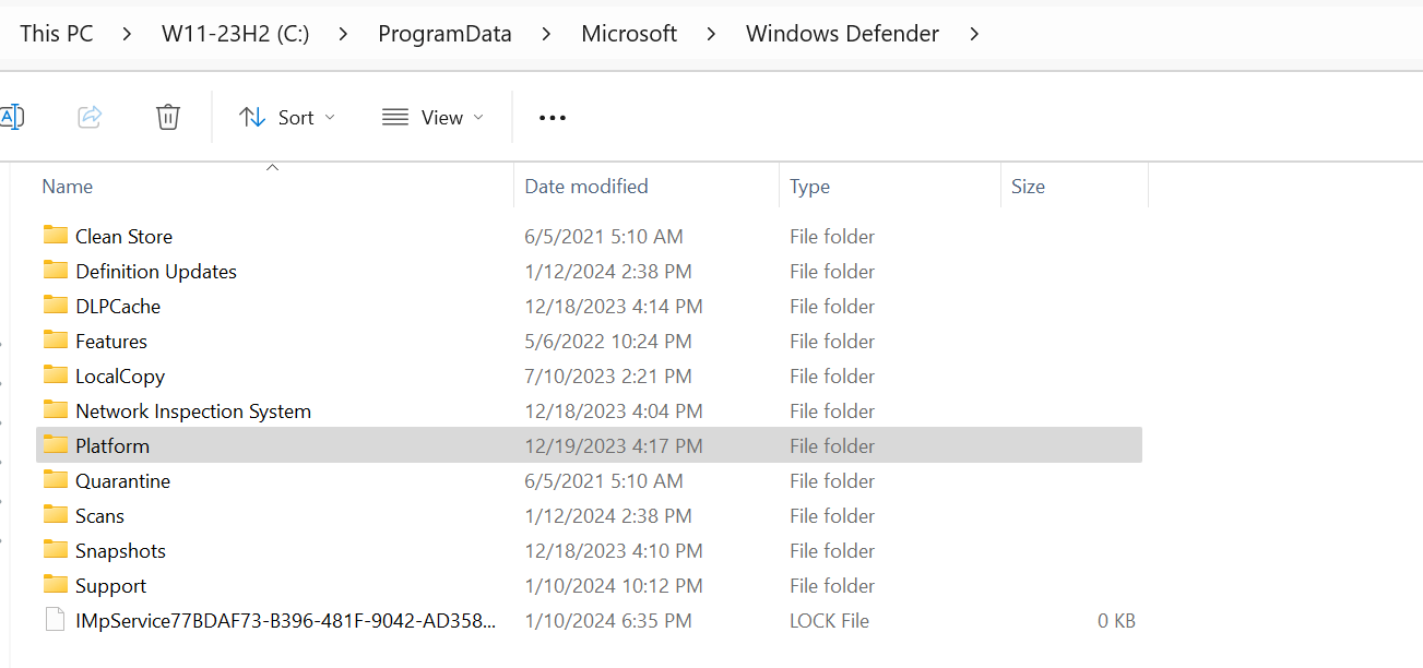

Some files are in here:
C:\ProgramData\Microsoft\Windows Defender\Platform
All I know is where KB5007651 is installing the updates, the latest one is Version1.0.2311.17002-0 and the SecurityHealthSetup.exe both received on Jan 4, 2024.
MS is not distributing the updates to all users at the same time, it may take weeks on some machines.
What I did to get the same updates on other machines, I just copied the folder below with all contents and the latest SecurityHealthSetup.exe
to a Temp folder on the other machines and right click on the SecurityHealthSetup.exe and run as Administrator.
That installs the updates. It may take a few minutes to show up in the System information.
After that I reboot to get the updates to take effect.
The Windows Security Application Version: 1000.25992.0.9000 and Windows Security Service Version: 1.0.2311.17002-0

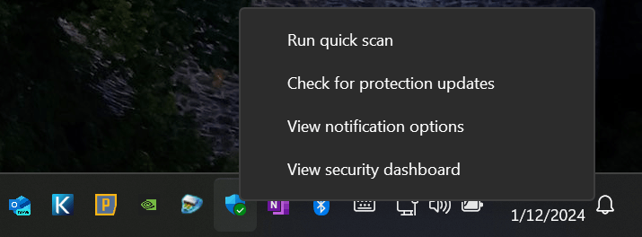

are the latest versions which fixed the problem of the System Tray security icon Right Click context menu that was missing for over 6 months.
Right Click context menu working again. πŸ‘

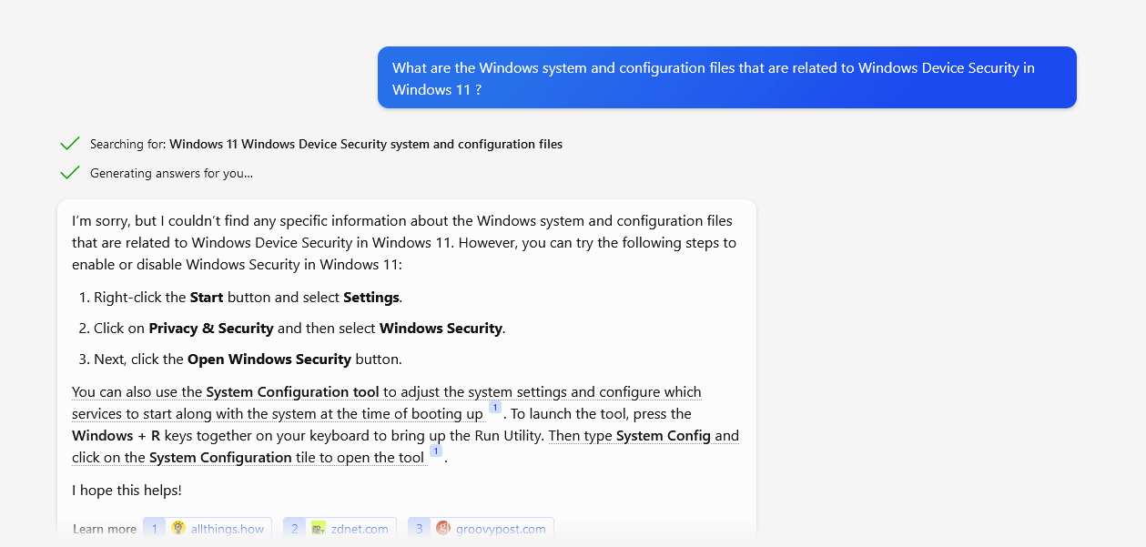

    Back to the issue itself, I remember having, in the previous instance when it did occur, to have found that a number of Windows system or configuration files related to security were missing for some reason on my Windows 11, while on another exactly similar laptop, these security files were present on C. I tried to find that information on Windows Learn and with Windows Copilot (see attached screenshot).
    https://learn.microsoft.com/en-us/windows/security/operating-system-security/system-security/windows-defender-security-center/wdsc-device-securityImage
    If this information is available in Windows documentation, I would be able to check if those specific files are - again - missing on my computer after the reset and we may have then underpinned the root-cause.
