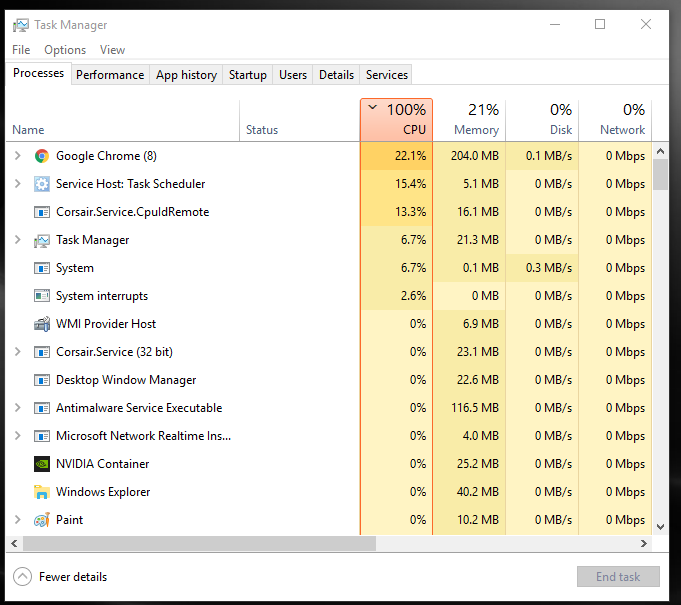

So as you can see from the picture below, i have 100% CPU usage and it doesnt even add up to 100% half of the time. After being connected to MS support for about an hour, the only thing they have 'helped' me with is uninstalling chrome so that I may use edge to reinstall it (I guess they are that desperate to get more edge users). They had told me that reinstalling chrome will fix the issue as "chrome could be the issue" well, it wasn't, and I knew it want because I've been using chrome since someone told me how efficient it was over iexplorer.

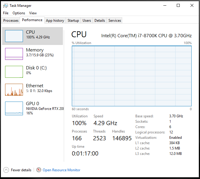

Anyway, I have an issue with Windows 10 Pro that results in task manager acting up in such a way that makes it state my CPU usage at its highest, as you probably already saw from the second picture, its an i7-8700k.... and nothing else is out of the ordinary.

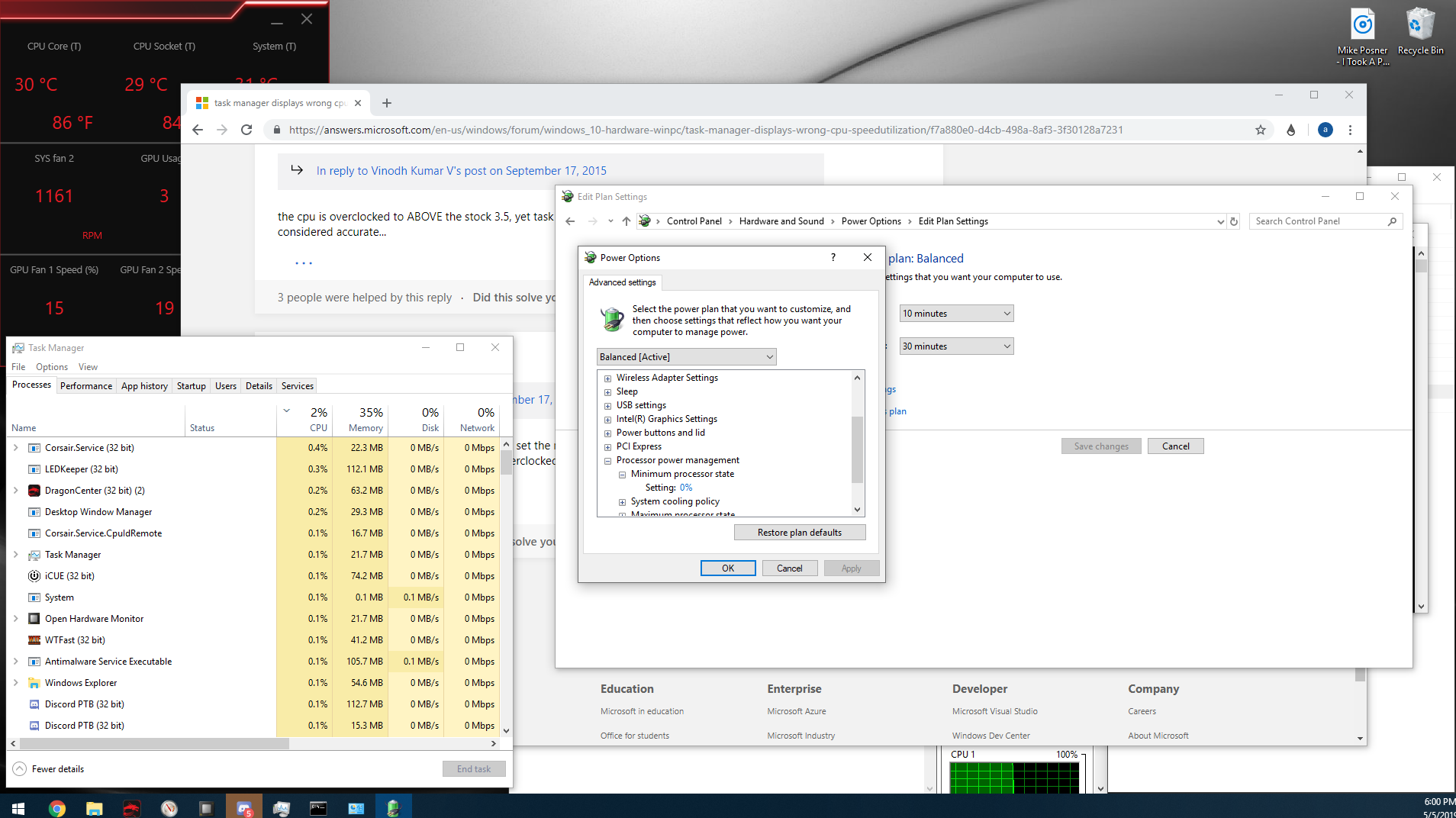

:Resolution:
Issue was resolved changing the power plan settings shown here
the issue was that the minimum state was set to 100, after setting it to 0 and saving, the issue was fixed

    You may want to open the Resource Monitor and check your system there.  You can filter for the highest use processes and then drill down in the lower windows.  You are showing around 75% now so it may be some system process.
    I would probably get rid of the CpuID stuff, especially if it is an OEM utility version.  Are you running any more MSI utilities which came with the motherboard?
    Any chance there is some type of problem with the system build?  Any overclocking or performance enhancements and I see you say the processor is at factory clock but there are other things you can do?
    A system will run at high processor utilization at times in the normal OS.  But it should stop after a while.
    Have you tried changing the power scheme?
    The Service Host: Task Scheduler looks a little strange..
