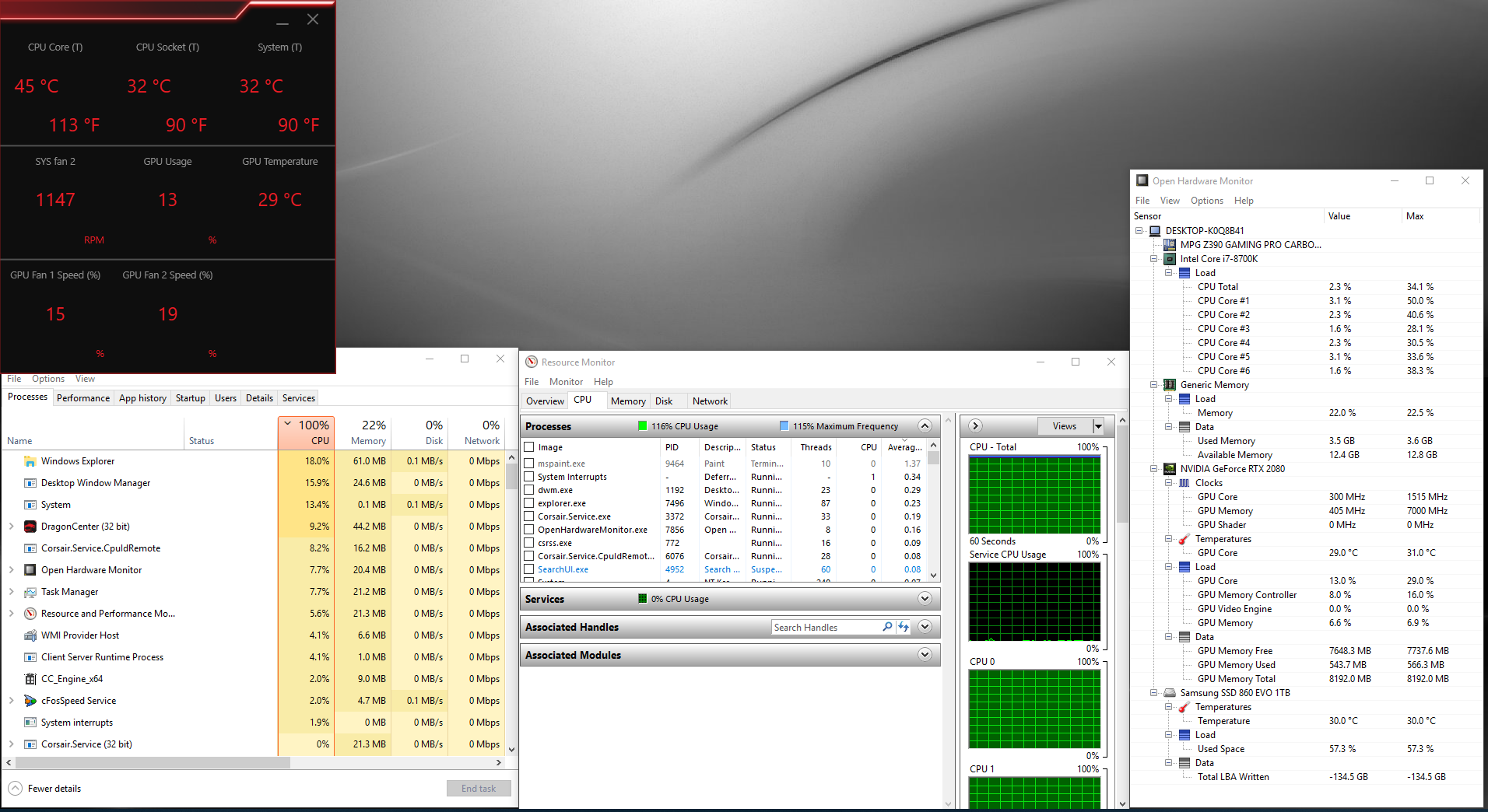

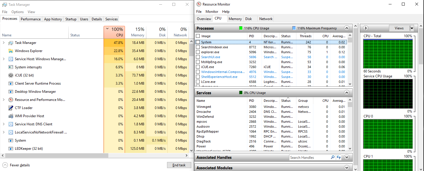

So as you can see from the picture below, i have 100% CPU usage and it doesnt even add up to 100% half of the time. After being connected to MS support for about an hour, the only thing they have 'helped' me with is uninstalling chrome so that I may use edge to reinstall it (I guess they are that desperate to get more edge users). They had told me that reinstalling chrome will fix the issue as "chrome could be the issue" well, it wasn't, and I knew it want because I've been using chrome since someone told me how efficient it was over iexplorer.
Anyway, I have an issue with Windows 10 Pro that results in task manager acting up in such a way that makes it state my CPU usage at its highest, as you probably already saw from the second picture, its an i7-8700k.... and nothing else is out of the ordinary.

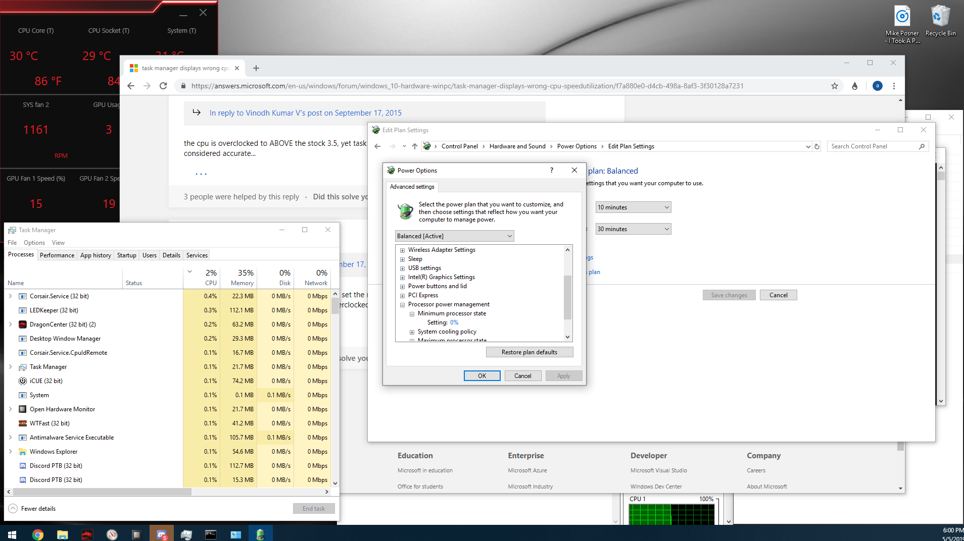

:Resolution:
Issue was resolved changing the power plan settings shown here
the issue was that the minimum state was set to 100, after setting it to 0 and saving, the issue was fixed

    2019-05-05T20:43:26+00:00
    everything is at factory clock, I opened the resource monitor and I barely know what I am looking at here....
    I ran DISM just to see if that would work... it didnt
    2019-05-05T21:00:44+00:00
    You can adjust column widths and CPU usage columns just like Task Manager.
    If you see a process running a lot, check the box next to it then go down to the lower windows to see what is moving or using the processor.  It may take you some time to get used to it but it can provide some good info.

    2019-05-05T21:20:35+00:00
    no, its actually fairly cold.... I got a hardware monitor which seems to be honestly accurate so it seems to be an issue with task manager itself
    MSI Dragon Center is what I use by default to monitor certain temps.... MSI cant detect the rpm. only the speed % so ignore SYS fan 2 speed
    as for the hardware monitor, Ive used them in the past and I just remembered that I should get one to help better assess the situation
    all these screenshots are taken current as I post replys
    2019-05-05T22:01:54+00:00
    The issue wasnt really resolved by you..... but you led me to the right area and i noticed the minimum state was set to 5% which was wrong, i tuned it to 0% minimum and now it is fixed
