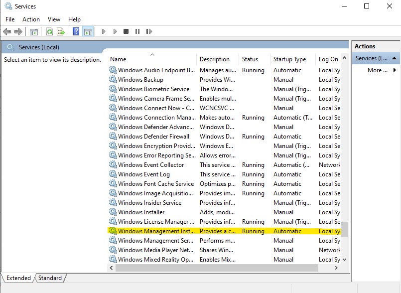

    3) Restart your WMI first, and run "c:\windows\system32\wbem>mofcomp.exe cluswmi.mof" as you have done for node A. Just click the Start menu and type in the search bar type 'services.msc', find WMI and right-click "restart":
