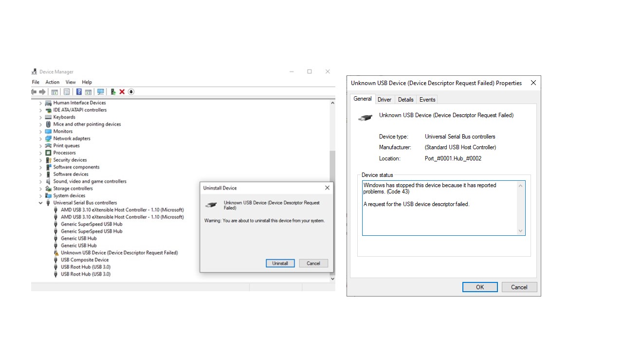

My in-built camera on my HP All-in-one pc has suddenly started "dropping out"
If I look in device manager  the camera isn't listed, but a usb device is highlighted as an issue, if I disable then enable that usb device the camera returns to the Device manager listing and works perfectly. Then, after a shutdown or putting the pc to sleep the camera is not listed/working.
I haven't made any particular changes that I'm aware would provoke this issue.
See screenshots below - as I say, once the erroring usb device is dis/enables the camera is listed and works fine

    Looks like your camera is internally connected to USB that you are uninstalling
    I think there 2 cases for this problem - USB and camera drivers issue and camera firmware damage issue
    At first reinstall USB drivers and camera drivers from manufacturer drivers
    If issue is not resolved then it is probably camera firmware issue and you need to update camera firmware if possible
    If camera firmware cant be updated you should install correct driver for this device manually by forcing it to install driver you specify

    Display Message
    "Windows has stopped this device because it has reported problems. (Code 43)"
    Recommended Resolution
    Uninstall and reinstall the device.
    One of the drivers controlling the device told the operating system the device failed in some manner in response to IRP_MN_QUERY_PNP_DEVICE_STATE.
    With the Camera working
    Type in the Start - Search box --> Create a restore point
    Find at top and click on it - Create - make a Restore Point
    In Device Manager Right Click the camera and uninstall the camera
    do the same with that USB device.
    Then restart the computer.
    The device should be re-installed after the restart.
    If not then use the method you previously have to restore the camera. If that does not work use the Restore Point.

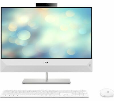

    Thanks for the swift response. You're correct, I should have mentioned, the camera is a "pop-up" one - it's integral to the pc and slides down into the body of the screen when I don't want to use it.
    My pc is an HP Pavilion All-in-One - 24-xa1009na  (photo below - camera popped-up above the screen)
    I've just noticed that the disable/enable option doesn't work unless the camera is up, "out of the pc body" - I'm sure this wasn't the case before, as it used to prompt and look for me for facial recognition (facial recognition now displays it "can't start the camera, logon with PIN", so I've temporarily switched facial recog off)
