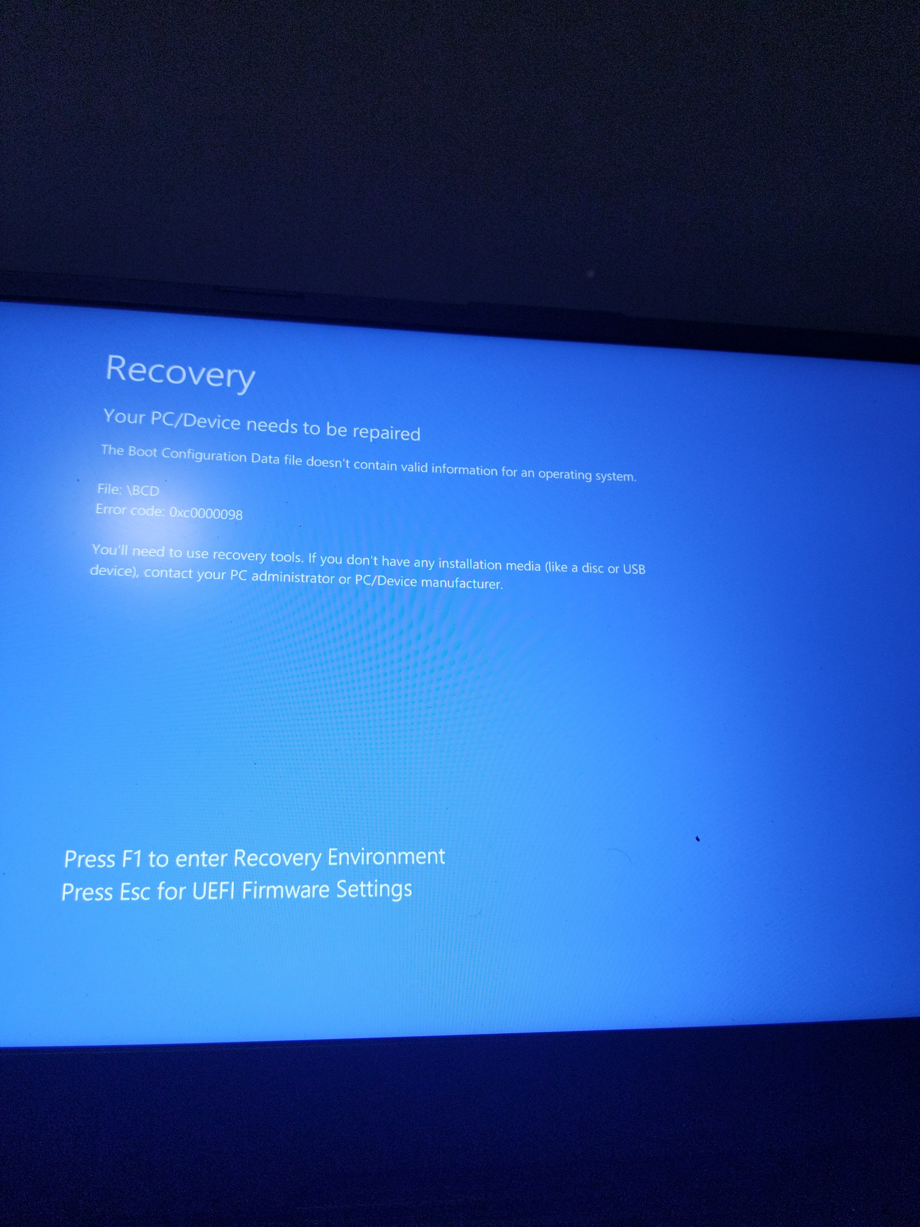

I was getting a 0xc0000225 blue screen so I tried doing several things, like rebuilding BCD using Console commands from the advanced startup only to encountering problems like path not found or access denied. I then tried reinstalling my latest windows update (Windows 11 version 23H2) the 0xc0000225 bluescreen stopped but it got replaced with my laptop booting up into a different menu.
1st photo
2nd photo
I can still log into my account and use my laptop but I wanna fix the bootup problems Any idea on solutions?

    Unfortunately new problem

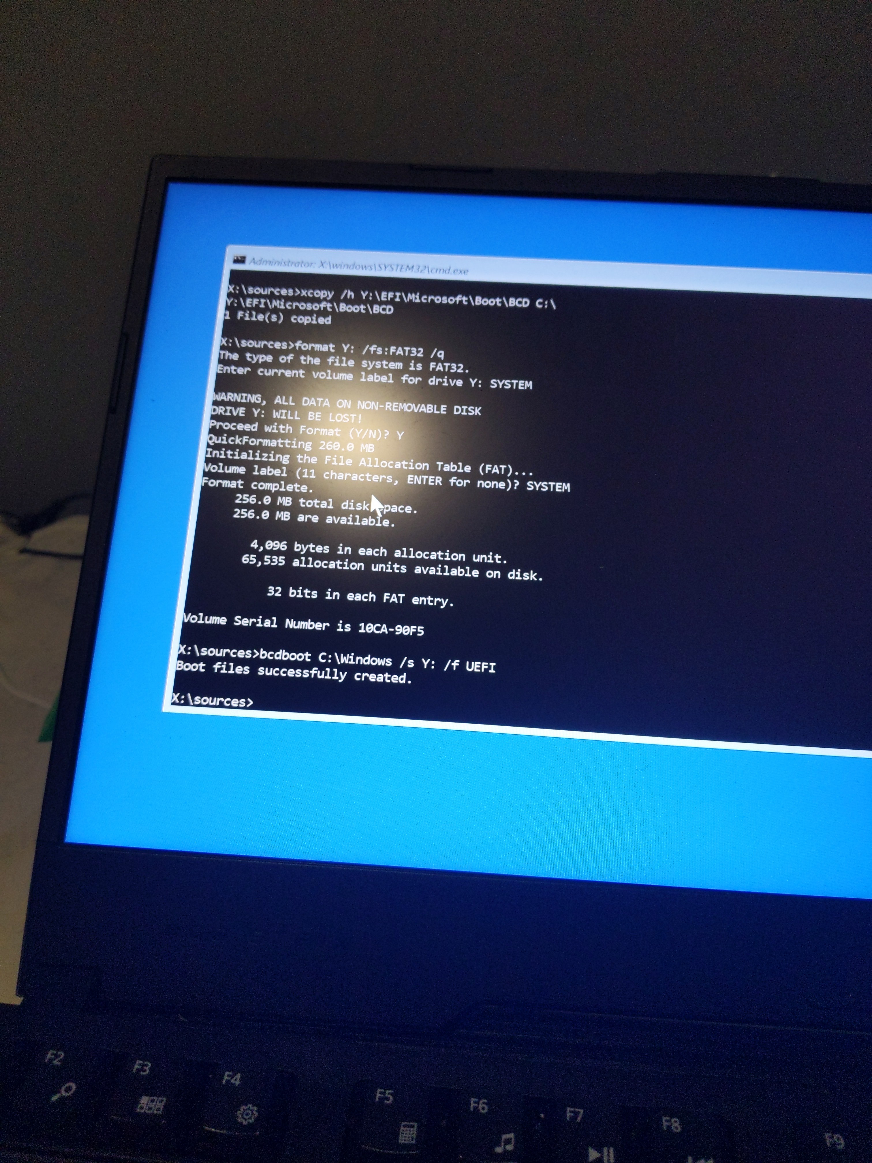

    The EFI partition is fixed. Please reboot the system.
    2025-02-24T03:27:42+00:00
    Output after bcdboot C:\Windows /s Y: /f UEFI
  4. Ramesh Srinivasan 81,535 Reputation points Independent Advisor
    2025-02-24T03:22:32+00:00

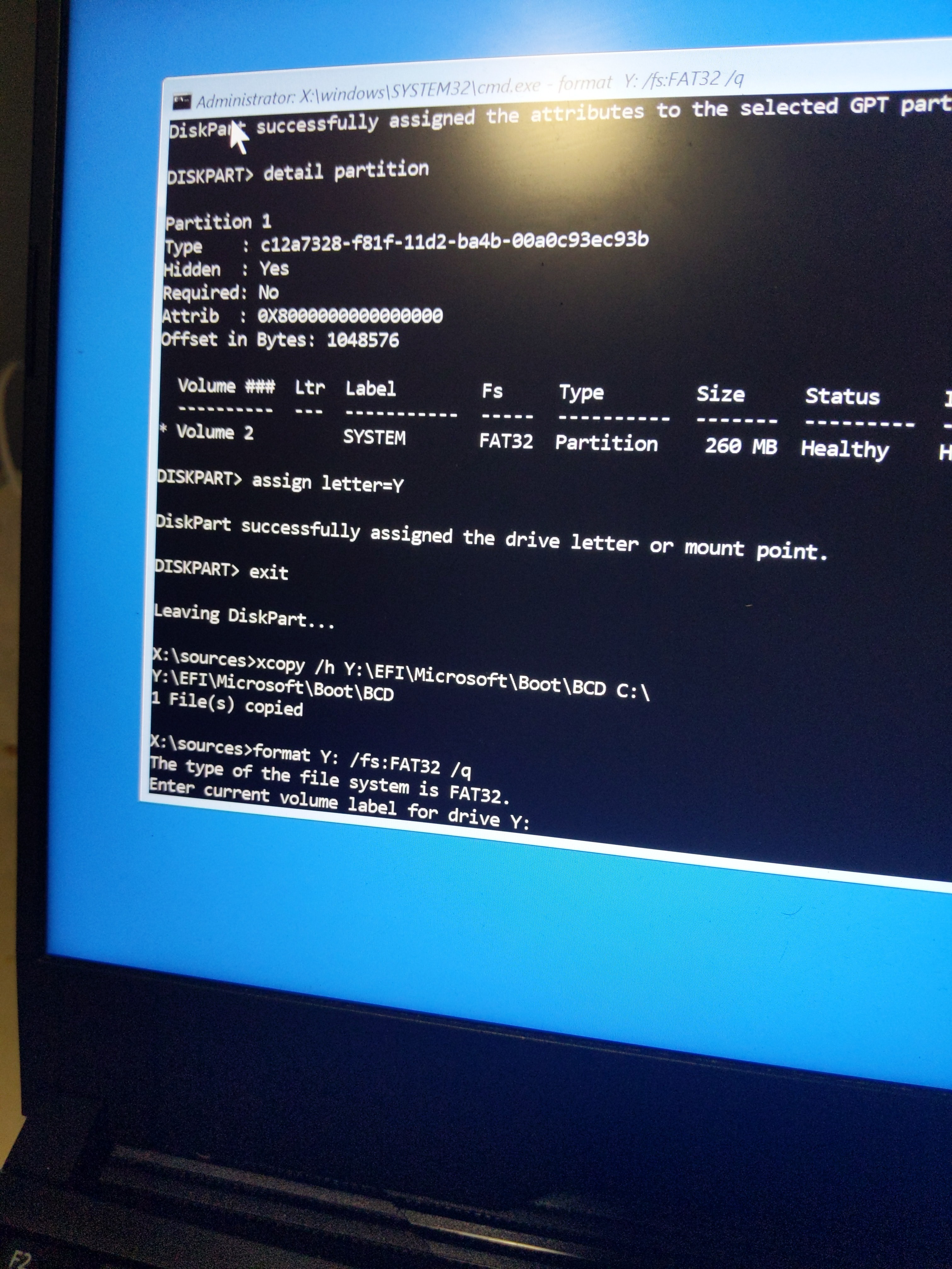

    Type the current volume label, which is "SYSTEM" without quotes, and press Enter.
  5. Anonymous
    2025-02-24T03:16:57+00:00
    I'm stuck on format Y: /fs:FAT32 /q
    I am assuming it is SYSTEM but I wanna double check
