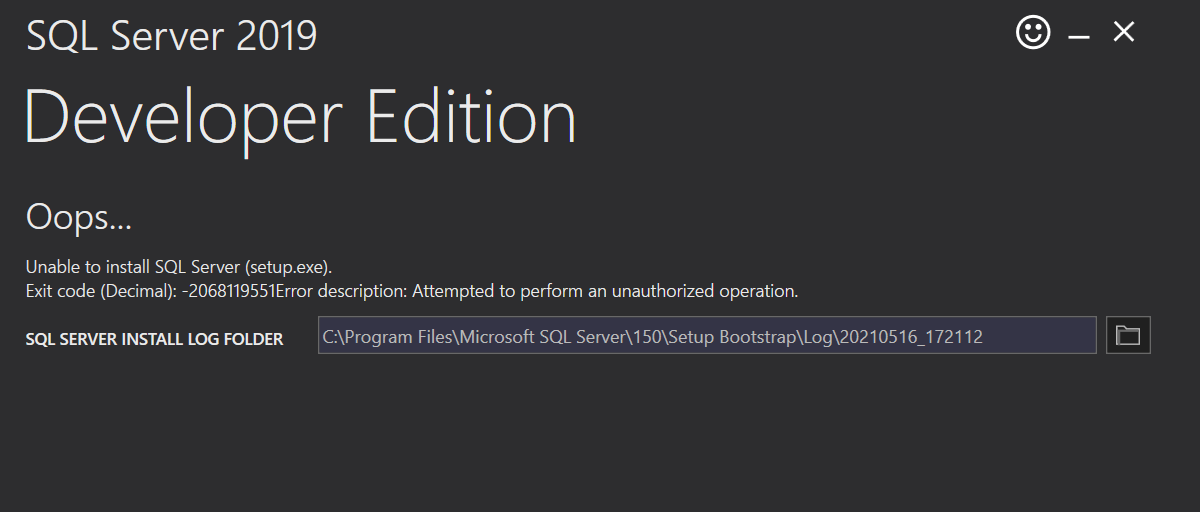

Hello Team,
I am unable to install SQL Server 2019. Below is the error every single time I try it:

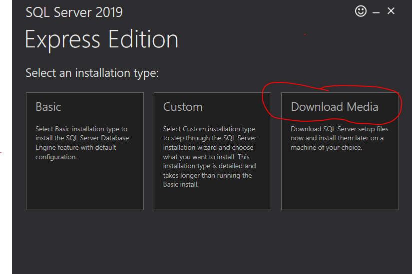

    Please try to download the SQL Server installation media to the local disk and install it by referring to this article..

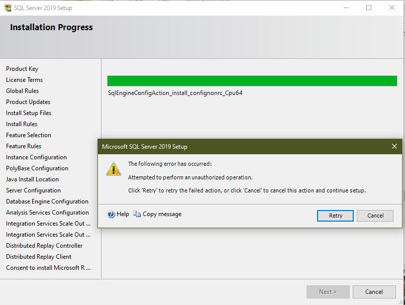

    I downloaded and installed BullGuard Internet Security on a VM that I had created for the task. I rebooted and then installed SQL Server, selecting every option. It jogged along for quite a while, but eventually I got this:
    I used Process Monitor to nail down exactly where things went wrong, and find that there was an error when trying to access the key HLKM\SYSTEM\CurrentControlSet\Services\FltMgr. This was also confirmed by my Details.txt.
    After having cancelled Setup, i found that I had an instance of the Database Engine in SQL Server Configuration Manager, but it was not running. I did not try to start it - I can guess how that goes.
    So we can be quite sure that BullGuard is the culprit. It protects this key, probably because it itself install filter drivers.
    Question remains what to do about it... You could try to disable it, but my experience is that this is not enough. When I have had clashes with an Antivirus, uninstallation has been the only alternative, and I've seen other people with the same experience. SQL Server usually runs if you reinstall the Antivirus after setup.
    You could try to hunt around in the configuration for BullGuard to see if you can permit ScenarioEngine.exe to access this key. But I would not have high hopes for success.
    As for all those failed installs, go into Programs and Features and uninstall them before you run Setup again. Not that these half-complete installs will block a new one, but your machine looks kind of ugly. I'm running the uninstall so far, and at least so far it has not failed, but I will post an update later when it has completed.

    2021-05-17T22:09:35.343+00:00
    In addition to Cris's post, there is a folder in the error message. This folder includes lots of log files that give you more information. Start with summary.txt,
