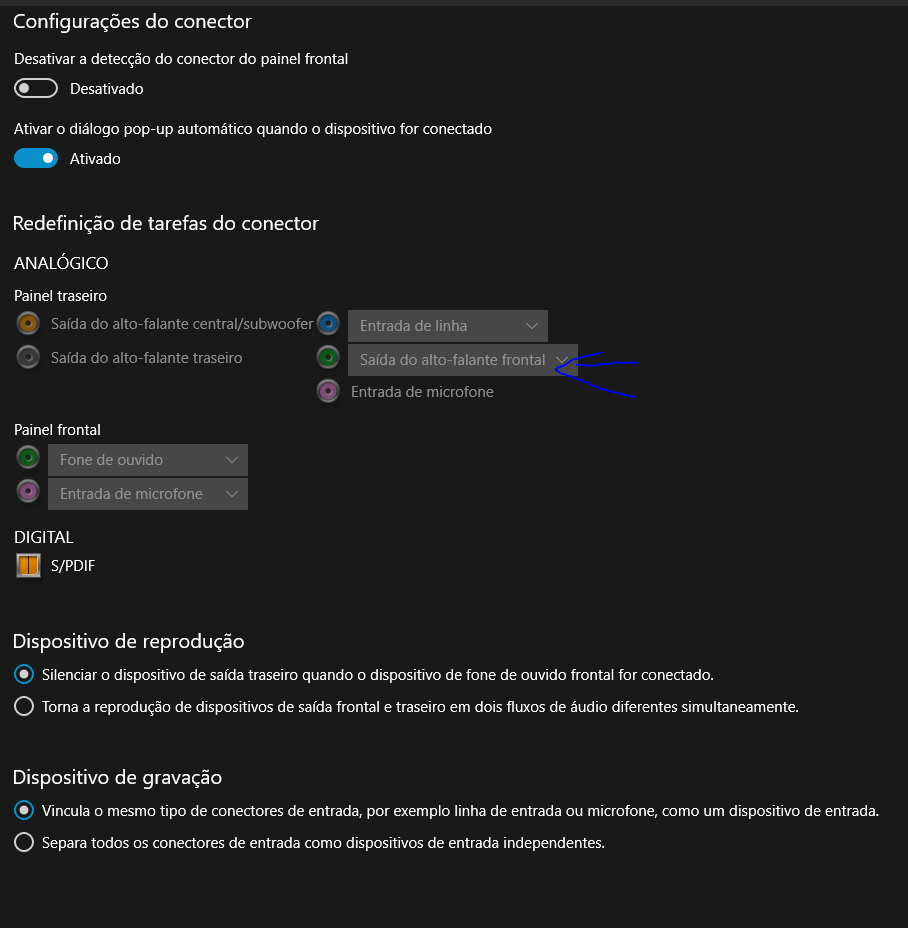

    Hi ,
    Open Realtek Console Panel > In the Advanced Device Settings tab > Select the input and mode of What type of device is connected.
    Hope this helps.
