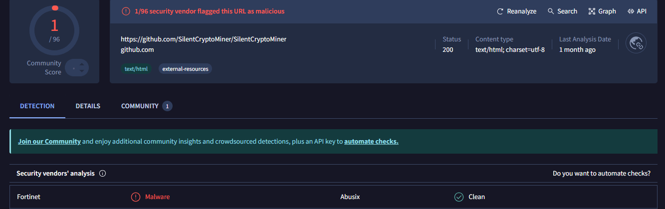

    2025-01-01T02:54:30+00:00
    AlexanderNicols1, in response to your suggestion, see my screenshot from VirusTotal.
