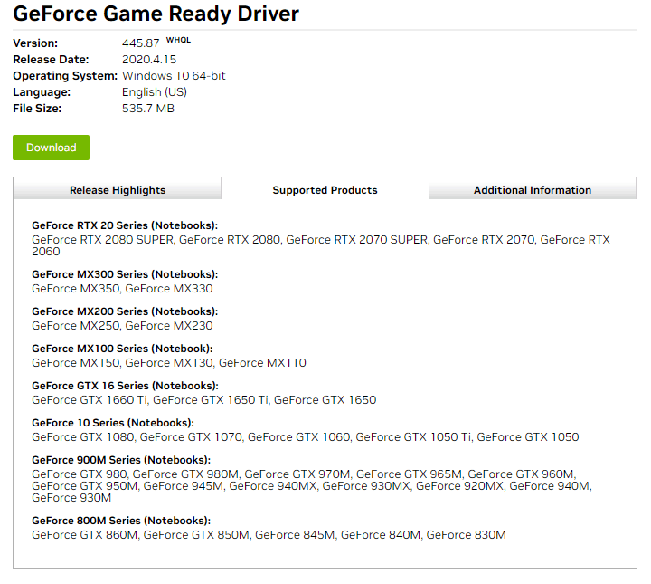

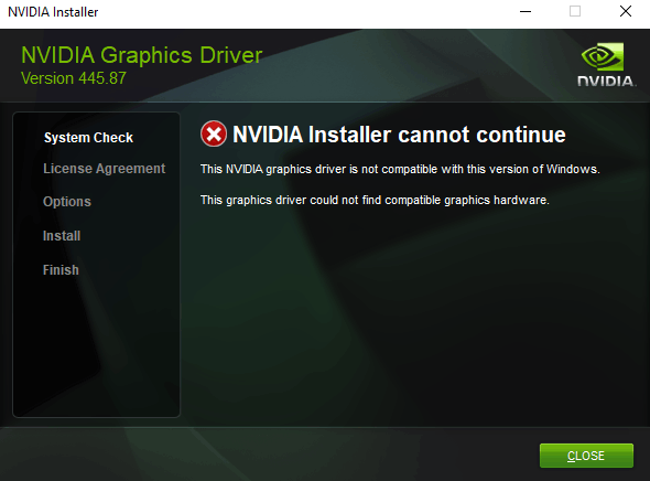

    i tried different version of the gpu drivers and still the same, I found an old one but when i try to install it says that its not compatible but when it clearly says its compatible with my laptop.
