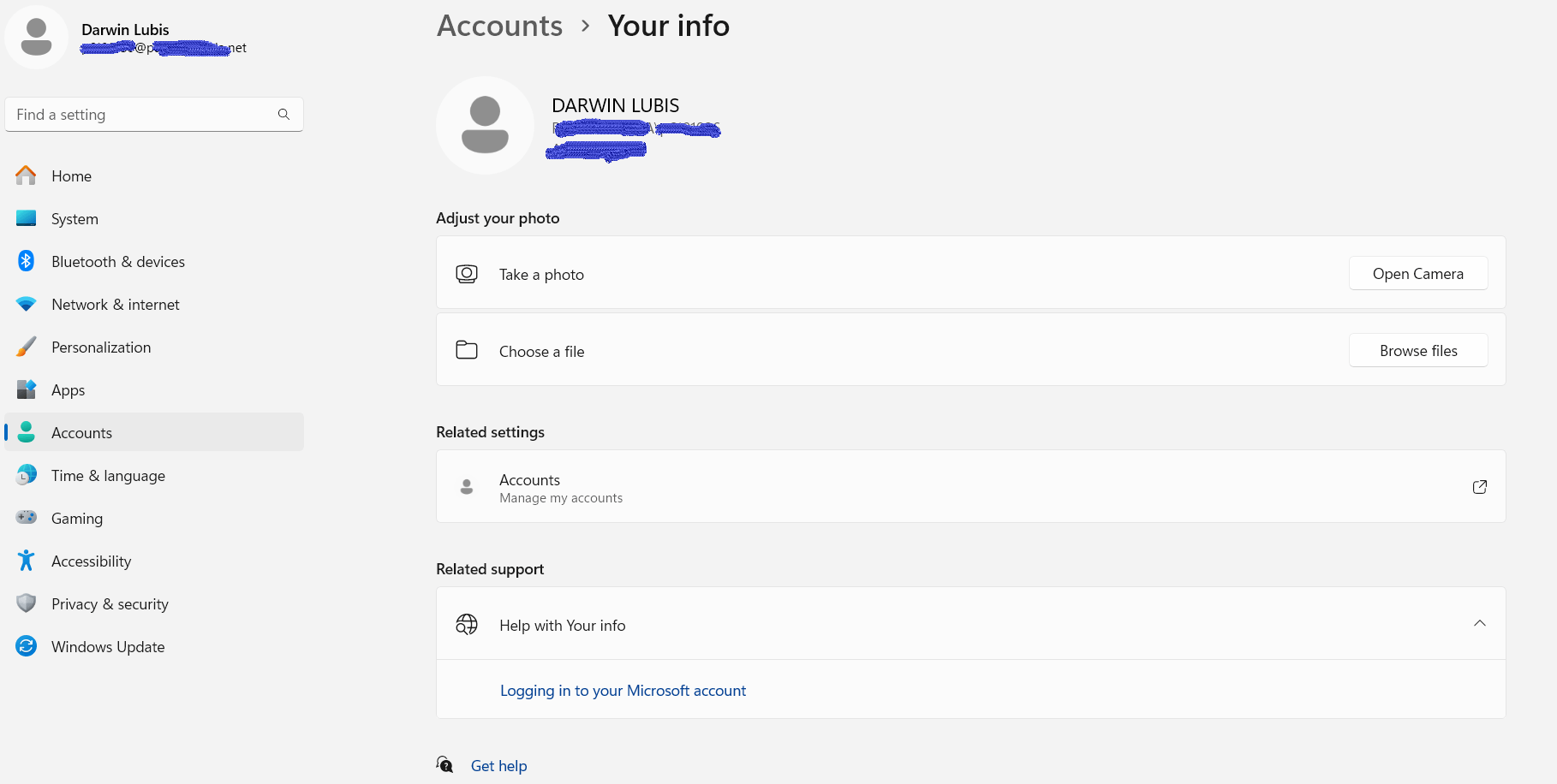

    2024-09-05T06:16:26+00:00
    it looks like you are already using a local account with a blank password.
    in settings -> accounts -> your info, under account settings does it say sign in with a "Microsoft account instead"?
    does it show your email address beneath your profile name on the top of the left hand panel?

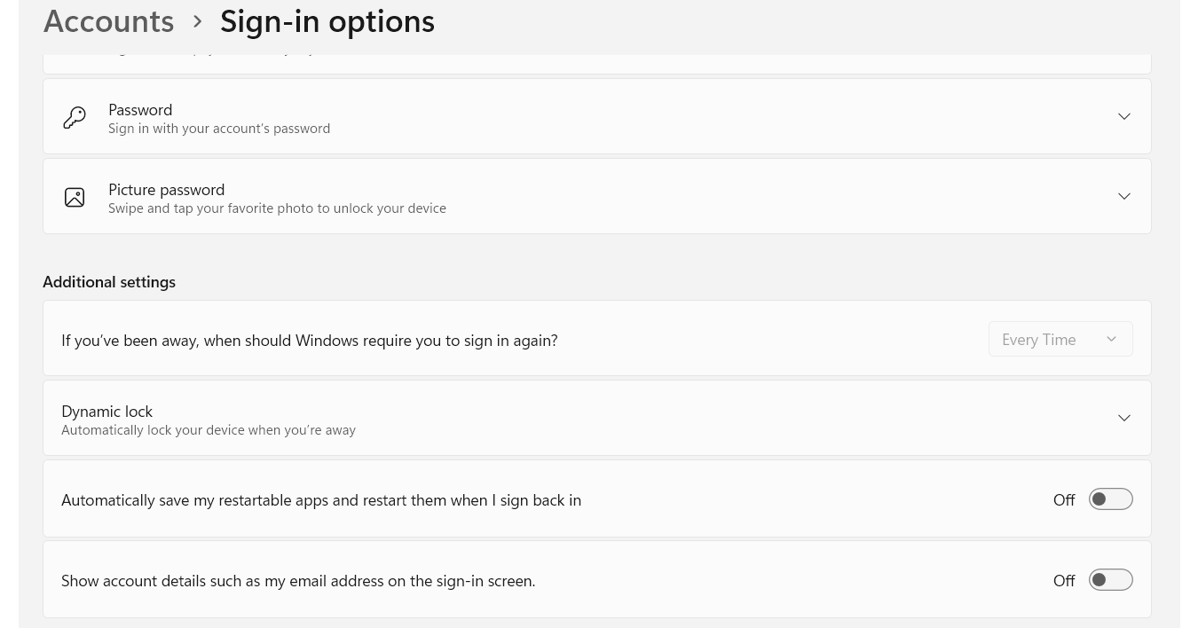

    I've the same problem... the remove button in pin field is greyed... there is no toggle option
    And already email under the account ...
