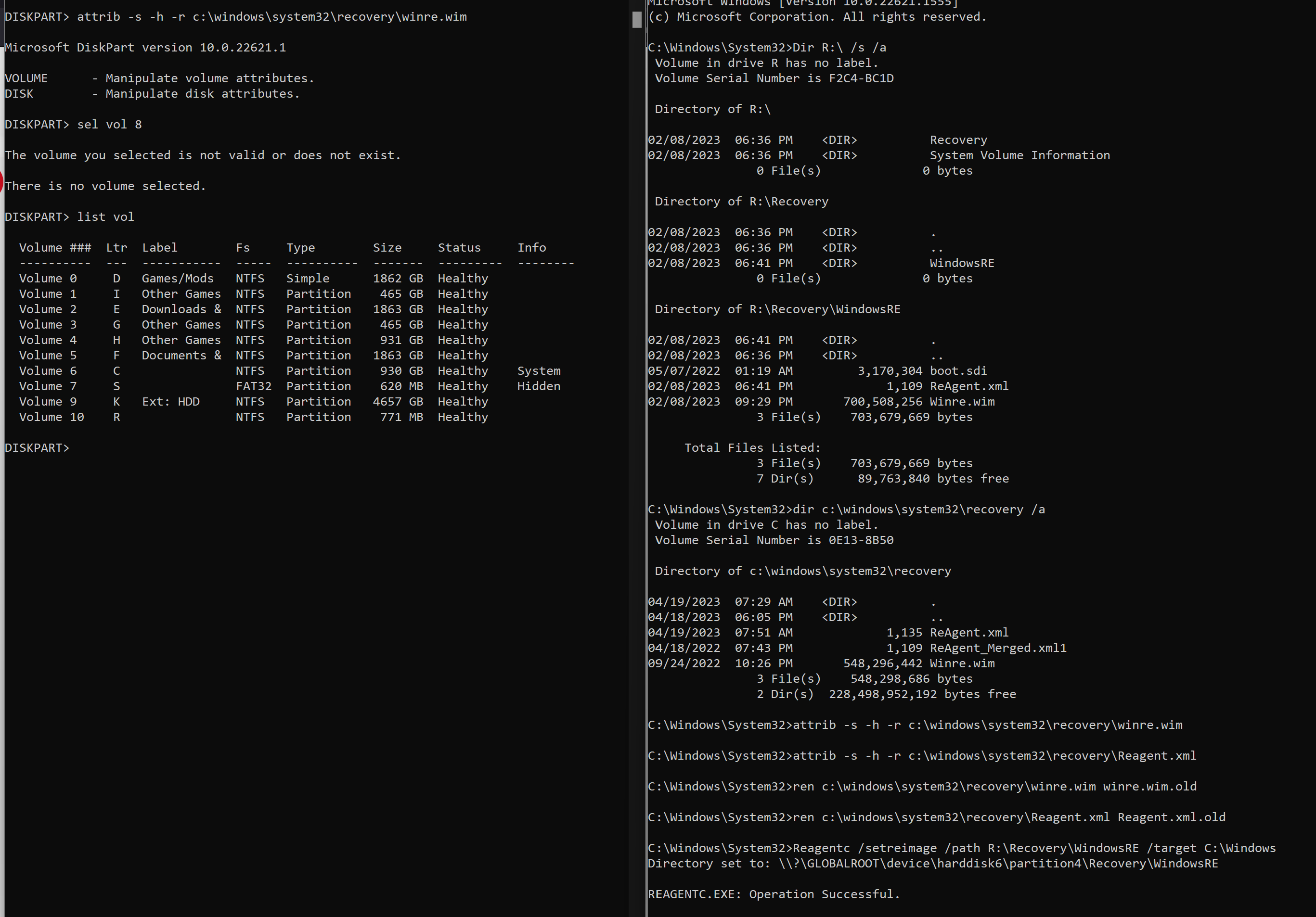

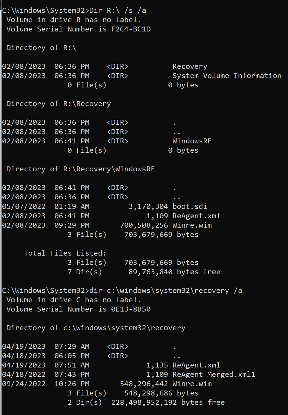

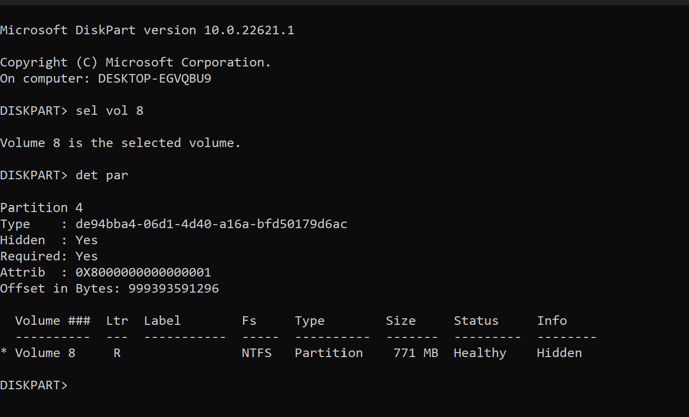

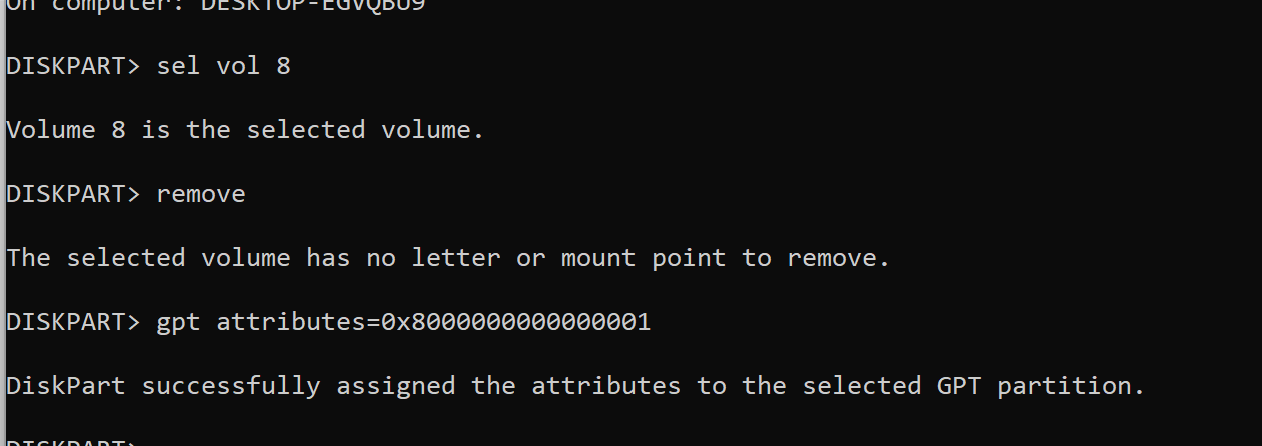

  3. Ramesh Srinivasan 173.7K Reputation points Volunteer Moderator
    2023-04-19T17:04:14+00:00
    Run:
    • diskpart
    • sel vol 8
    • set id=ebd0a0a2-b9e5-4433-87c0-68b6b72699c7
    • gpt attributes=0x0000000000000000
    • exit
    then run:
    • attrib -s -h -r c:\windows\system32\recovery\winre.wim
    • attrib -s -h -r c:\windows\system32\recovery\Reagent.xml
    • ren c:\windows\system32\recovery\winre.wim winre.wim.old
    • ren c:\windows\system32\recovery\Reagent.xml Reagent.xml.old
    • Reagentc /setreimage /path R:\Recovery\WindowsRE /target C:\Windows
    And then run:
    • diskpart
    • sel vol 8
    • remove
    • set id=de94bba4-06d1-4d40-a16a-bfd50179d6ac
    • gpt attributes=0x8000000000000001
    • exit
    Please post screenshots.
    2023-04-19T17:17:51+00:00
    It seems that volume 8 is now 10? Should I select that instead?
