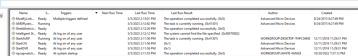

    here's a screenshot of startup processes
    As you can see these processes run as soon as the system is logged on
    the powershell process runs much later and when i check scheduler to see what started it, nothing. No process ran at that instant.
