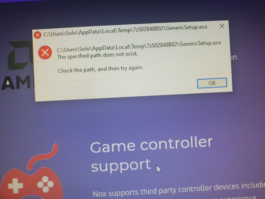

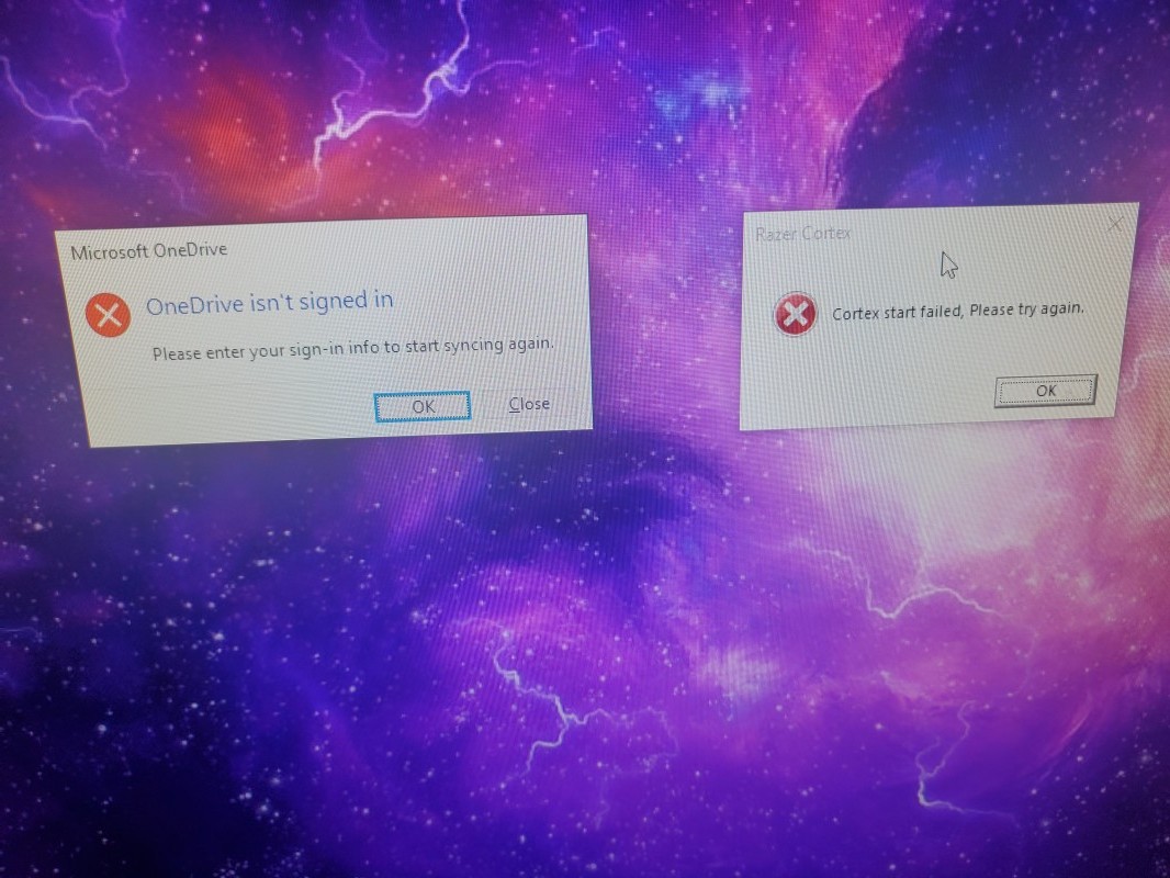

    This is what happens when I try to download NOX Player and I also can't sign into one drive it just closes and shows this window.

    Did you complete all of the steps? This sure sounds like account corruption which is covered in the Checklist in step 16 to create a new Local Admin account in Settings > Accounts > Family & Other People > Other Users, as shown here: http://www.howtogeek.com/226540/how-to-create-a...
    https://www.windowscentral.com/how-change-user-...
    Sign into the new account, test that it runs fine for as long as you want, if so then when ready move your files over, test that all programs work or else reinstall them.
    To try to repair the old account from the new one see: https://www.techbout.com/fix-corrupt-user-profi...
    You can also run a Repair Install which will sometimes fix the old account: Install the Media Creation Tool from this link http://windows.microsoft.com/en-us/windows-10/m..., choosing Download Tool Now, install the tool, open it and choose Upgrade this PC Now. . This will save your files and apps while bringing you up to the latest version by the most stable method. It will also bring all of your Updates current and solve most problems since it reinstalls Windows.
