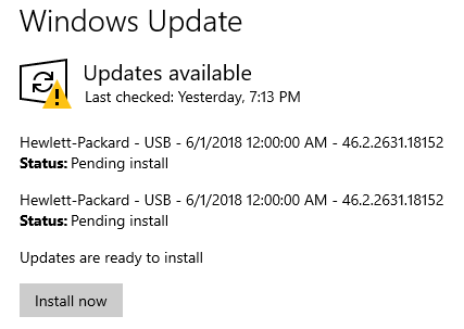

I am getting the below message while updating in Win 10. I do not know why the update is not being installed automatically
There were some problems installing updates, but we'll try again later. If you keep seeing this and want to search the web or contact support for information, this may help: (0x800f020b)
Hewett Packard-USB- 46.2.2631.18152
Installing-0%
Pending Install
The above messages are shown. The update is not getting installed and shows pending installation
Can someone guide me the reason with solution to resolve
Thank you
DR Rao.

    I am tired to see every time this error on the Windows update page. It is so annoying to see whenever we check for Windows 10 updates.
    What is the solution to eliminate this error permanently and who is responsible it it MS or HP. Either of them has to resolve this issue permanently.
