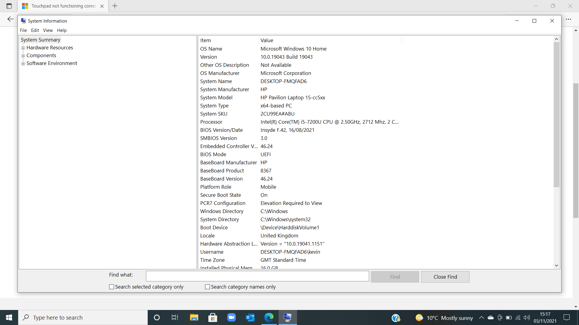

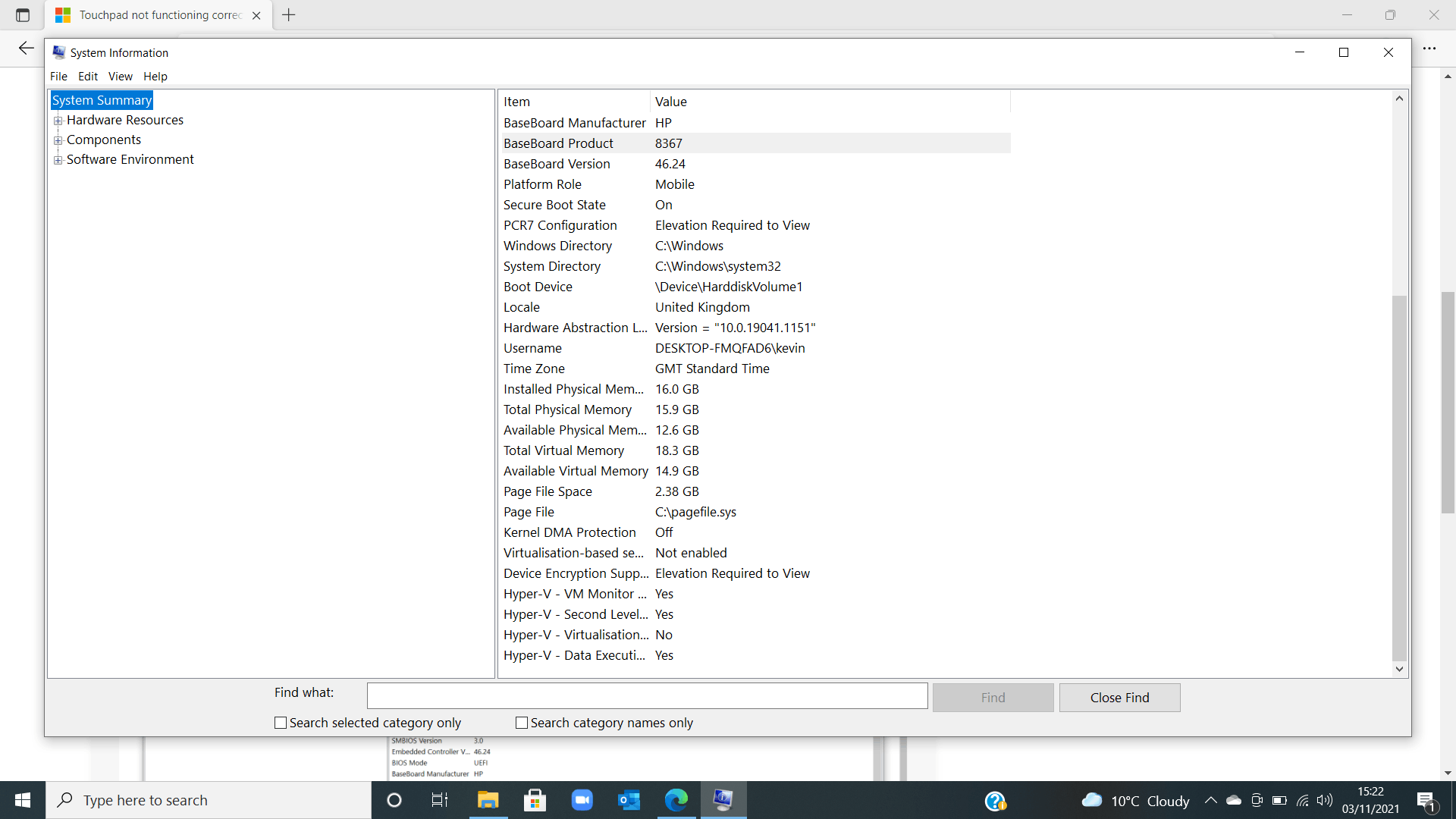

    2021-11-03T15:25:35+00:00
    Hi.
    Thanks for the response. Here is a screenshot of the system.

    2021-11-03T14:24:13+00:00
    Hello, how are you?
    My name is Paloma B., I am very happy to be able to try to help you in the best possible way.
    This is an open community, whenever you need you can share the problem so that possible repairs are suggested.
    Could you give more information about the problem, please?
    Could you share your computer model? Press Windows+R, type msinfo32 and click OK, when opening the info window, send me a printscreen please.
    We need to check the manufacturer's website to find the correct driver and install it so it will work again.
