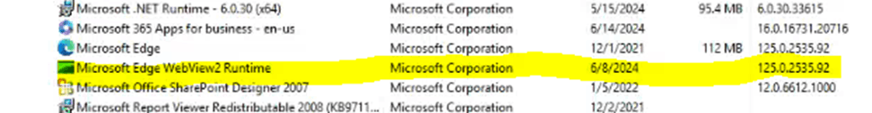

I verified the WebView2 runtime is up to date mostly. There is one newer version released yesterday 6/13 but should be ok since the version installed is only from 6/8 and is one release version behind.

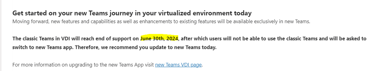

Announcing general availability of the new Microsoft Teams app for virtual desktop infrastructure - Microsoft Community Hub
As compared to the deployment document:
New Microsoft Teams for Virtualized Desktop Infrastructure (VDI) - Microsoft Teams | Microsoft Learn
