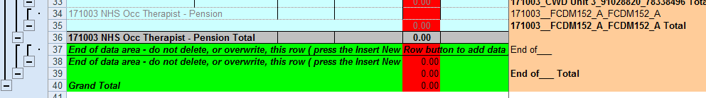

    In doing some testing, however, I noted that, when using your original table and the "long" array that did not work; using the "single cell" method and NOT removing that "end of data" line, the result is that the second level subtotals all wind up at level 2, as desired; but the "end of data" line is duplicated, with the Grand Total showing below it.  I don't know if that is useful information, but it is interesting.

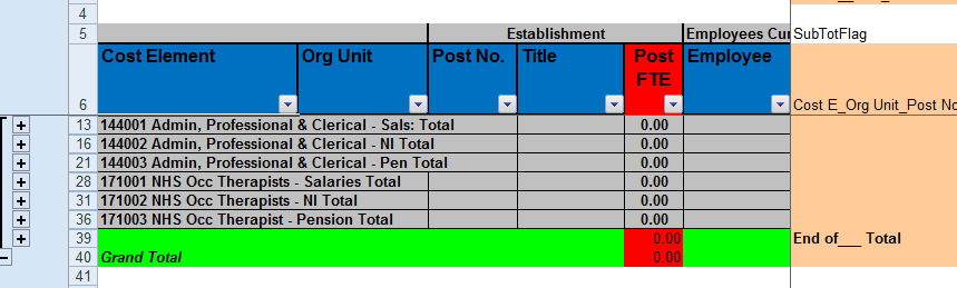

    Here are some screen shots of that phenomenon, on sheet CC3 of the sample file.  (Ignore the column with the Red interior; I was coloring the subarray columns to see if there was anything there that would provide a clue.
    Expanded View:
    Collapsed to Level 2 subtotals only
