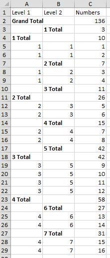

    I found a similar issue in Excel 2010 where multilevel subtotals when placed above the data do not place the totals line in the correct space.  This happens when one set of data only has one distinct combination between levels 1 and 2.  Its easily replicated, but I do not know if Microsoft is aware of it or has a hotfix for it.
    See example below, where the data set Level 1 = 3 and Level 2 = 5.  When I added the 2nd level of subtotalling, since there is only one combination of 3-5, Excel doesn't know how to handle it and places the 2nd level subtotals in the wrong place.
