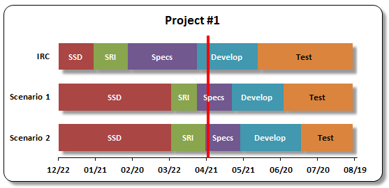

    Thanks for your help, but please keep in mind that when I change the new series' chart type to a Line chart, there is no secondary X axis.  Instead, there is a secondary Y axis.  That's why I arbitrarily set the minimum and maximum values to zero and 100, respectively.
    It may be better if I showed you what I'm trying to achieve.
    Unfortunately, the vertical line is not lined up with today's date (3/2).  I thought my 6-cell range would do the trick, but apparently not.  I would greatly appreciate any assistance you can provide.
    Thanks again.
