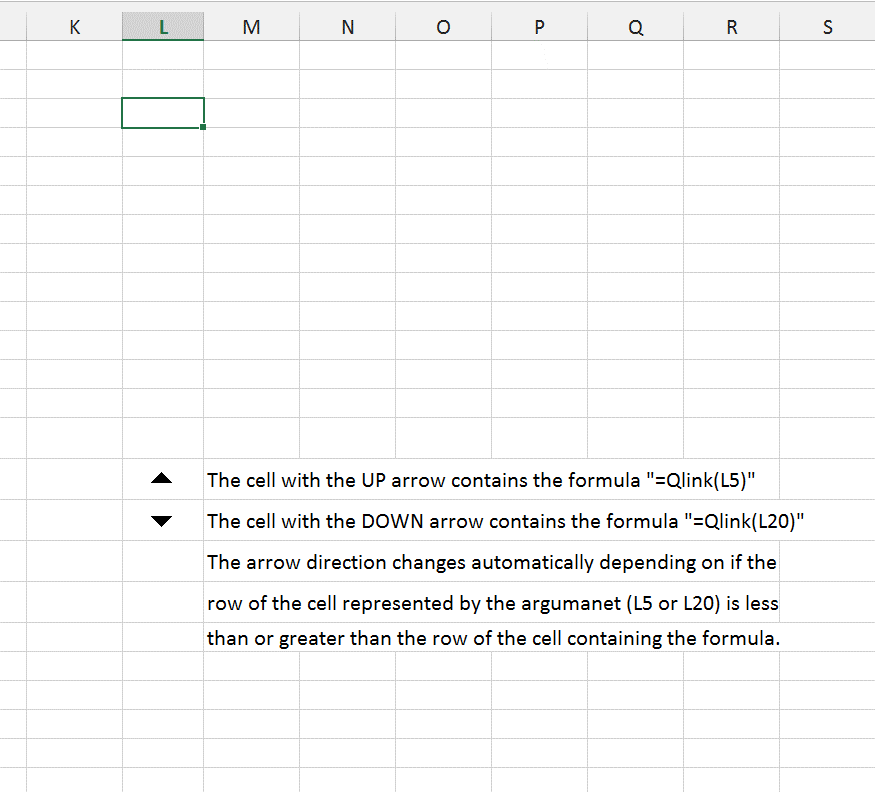

    I'm probably not understanding you, but I thought I'd fire off something hoping it will help. Be advised that this came from just goofing around. It's not what you asked for but I thought I'd offer it as an alternative. It's fairly quick to implement. Just enter, say, "=QLink(J50)", format the cell as "Marlett" with size 18 font and you're done. In this case, clicking the cell will cause selection to jump to cell J50. Detailed instructions follow.
    Suggestion:
    1)  Format the font of the desired cell as "Marlett",
    2)  Set the font size to something suitably large (e.g. 18),
    3)  Type "=QLINK(L100)" into the cell,
    4)  Paste the below Worksheet_SelectionChange code into the worksheet's Class module,
    5)  Paste the below QLink function code into a standard module.
    Note that the number 5 in Marlett font looks like an UP arrow and the number 6 looks like a DOWN arrow. The function itself will change the arrow to point in the appropriate direction, either up or down, depending on if the destination is above or below the cell containing the formula. See the below picture.

    Function QLink(c As Range) As String
    Select Case Range(Application.Caller.Address).Row
    Case Is < c.Row
        QLink = 6
    Case Else
        QLink = 5
    End Select
    End Function
