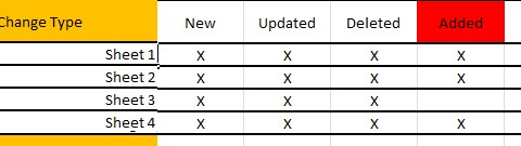

    2014-05-29T14:37:47+00:00
    XOR,
     I have a range of cells B2:E2 each of which contains a keyword, underneath this I have a range of cells B3:E6 each of which contains either X or "" depending on whether a specific sheet in the workbook contains the keyword  ...
    In this example there are 4 columns but this is not always the case. As you can see Worsheet 3 does not contain the keyword Added - so that cell is hilighted.
    Mark
    Ok, so with B2:E2 highlighted in the sheet (and B2 the active cell), define a custom, formula-based Conditional Formatting with this formula:
    =COUNTIF(B$3:B$6,"")>0
    Is that what you were after?
