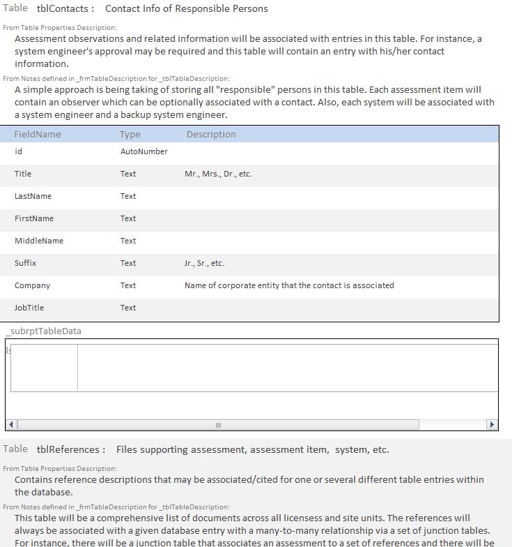

I have a table containing the names of tables in a column called TableName alongside descriptive information. I would like to follow the descriptive info with a subreport with a "SELECT TOP 5 * FROM <TableName>" which provides the top few rows for the table. How do I set the row source for each subreport to theTableName value? I am having trouble figuring out which event to use and/or how to access the master tablename for each subreport rendered. Advice?

    2016-03-11T17:47:45+00:00
    Scott,
    Thanks for your thought filled response. I am a bit hung up on some of the details (lack of background on my side). In response to your items:
    1. Yes, I did look at the documenter. Although it provides good technical details it does not appear to pull in the field descriptions or the table description from the properties. I may be missing something; so, please confirm that this is the case. Also, I create my own form for descriptive information on a per table basis which is comfortable for the documentation phase. Here is a snippit from my report on a couple of general tables being reported on (with the empty box being my unsuccessful attempt to pull in example data) ...
    ... report continues with field descriptions, table data, and then on to the next table for the next set of descriptive sub-reports.
    1. So, the fields information is a sub-report. Let me know if you still feel that a sub-report is not appropriate. Not sure if I follow and think that maybe my description was not sufficient previously for you to understand.
    2. I am fuzzy on scope / sub-report location here. So, I am placing a sub-report next to (but not within) the subreport discussed in item 2. I don't follow  when you say group footer (the pager footer is not desired as I want the data to be shown alongside the field data). My problem is that I can not find the right event (and item to tie the event to) in order to set the row source. I have tried the OnPaint - but, it does not seem to fire per sub-report. In other words each time it fires all the row sources get set. So, maybe I am just missing the right event/object pair - but, I am feeling like what I want to do is not possible. Still a good chance that I am missing something basic ...

    I am able to generate a nice report with the main report being represented by the tblMyTableDescriptions and then a sub-report which provides the field data for each table in tblMyTableDescriptions. This makes for nice database design documentation. My thought is that it would be nice to extend the sub-report so that "example" data is provided by taking existing records and showing those in the sub-report.
    Is there a way to dynamically set the row source for a listbox within a sub-report? That is, for each sub-report produced I want to set a different row source. Let's say I have Table1, Table2, etc. defined in my database and described as rows in tblMyTableDescriptions above. Is there a way for each sub-report to contain a listbox whose row source changes for each sub-report? So, the first subreport list would have a row source of "SELECT TOP 5 * FROM Table1", the second report row source of "SELECT TOP 5 * FROM Table2", etc. where the table name is provided from the master table (ie. tblMyTableDescriptions).
    I presume that UNION suggestion does not fit my problem given that UNIONs typically combine like fields while each of my Tables will be have entirely different fields. I think the UNION suggestion is a result of my original question not being clear. Hope this clarifies. Thanks again!
