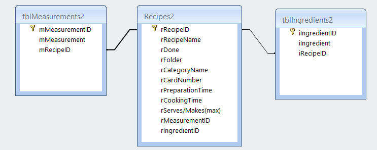

    Ken, you seem to have a well of information which is great. Although as I have 1 ingredient used more than once in the same recipe I kind of ruled out the multi-list box option. I noticed in the relationship model you had in your reply, there were 2 PK's in 1 table. How do you do that? Is that so you save creating another table to join them up, and instead have 2 one-to-many joins in the same table. The GetToken and InParam functions are way over my head, so I will hold off on this if I can get it functioning without them. Although I will keep it in kind, thanks.

    First, the foundation of any well run database is a proper table structure. So before you start designing forms, reports queries, you need the table structure done right.
    As the others noted, from your screen shot it looks like your tables have field for 15 ingredients and that is not correct. The structure Scott Mcd or what is in Gina's demo is what you need to achieve.

    You have jumped form Table to Forms way to fast.  As we have all pointed out you MUST get the Tables correct first.  Think of it like building a house... you plan to hang drapes before the foundation is poured?  So, can we please have a screen shot of your tables and how they are related to each as you have them now.
    Trust us... you get these Table right and everything else because easier.

    Looking at the impressive road map of a recipe database that Gina attached, just wondering is it best to link all table ID field together. I assume this would mean you need to duplicate the ID field from your first table into your second and join as one-to-many. Does this method eliminate the need for lookup fields?
    My logic may not be the same as access', but I assume I need to state somewhere which ingredients are in these recipes. I can't figure out how this works, although obviously it is important to link the information. I don't see how you guys have it all coming together for a list of ingredients for 1 recipe, I assume it all comes together after a form entry.

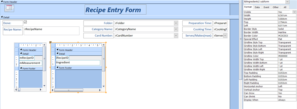

    As I was stuck with my original thoughts of how to carry this out, I have gathered some knowledge off my access superiors (you guys) and came up with this.
    With my new form looking like this (thought the Design view would help more).
    I thought I might have to do a subform, but as a didn't realy have any knowledge on that I wanted to try bypass this option.  As for Gina suggesting that I do this, I figure it had to be done. I decided to insert a new query as a subform for my main recipe entry form, just so I can modify the Field name for display in the form. Although it appears I can't edit it the fields in my form.
    I found while researching for a fix "Me.Dirty = False" (to be placed in a code builder I believe), my thoughts are that Access 2007 doesn't like the"Me."(not that I know much about this language). Even so I can't think of which property sheet field to put this in. If you think it may be something else I look forward to your assistance. I have inserted the 2 separate subforms from their tables as I couldn't get 1 with combined info (from a form/query) to work. (There might be a 'subform holder' which is locked and not allowing entry, but I can't find it.)
    Is there a way to get the subform to expand automatically without scrolling when more data is put in, and also can it jump to a new column next to these once it gets to the end of the page (so you don't have to scroll). I thought maybe there is a way to continue the same list of information after 10 entered lines, next to it.
