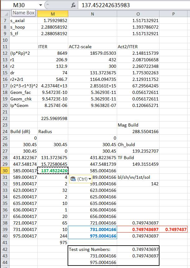

I've produced a Excel sheet with a non-linear equation (i.e. circular) which requires iteration turned on to converge.
All seems to work correctly and formulas converges correctly.
However several cells not related to the non-linear equation are in error.
Below shows the problem with Iteration on (itt:100::tol:0.0001):
Red cells are wrong.
The Blue cells are what is used in the calculation

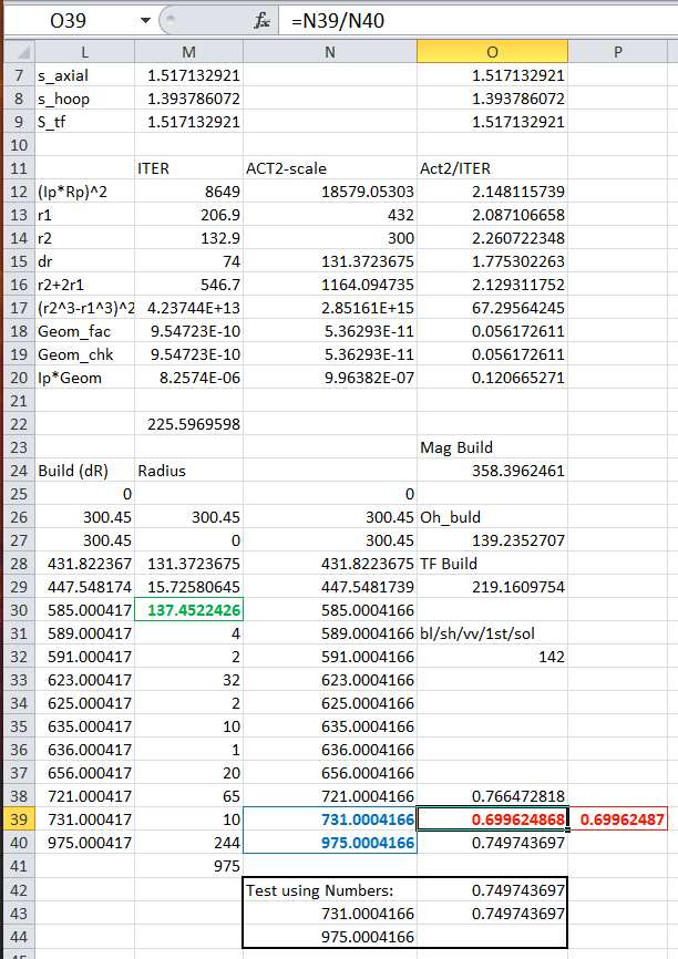

The green cell actually has non-linear interaction with some cells above (see 2nd figure)
Cell O39 == N39/N40 = 975.0004166/731.0004166 = (Should be 0.7497.. but is shown as 0.6996..)
The bottom box shows the correct (0.7497..) using only numbers.
I generated the same formula above (O38 ERROR and below O40 CORRECT)
Go figure. Ive used excel's non-linear convergence for 20 years and have never experienced this problem.
Any ideas, Tried it in PC 2010 & Mac 2011 versions.
I'm pretty stumped by this one and pretty sophisticated excel user. Would hate to go back to 2003 versions.
If I turn off the iteration of course I get a circular reference as shown below the error is still there
I can remove the non-linear equation by copy/past cell M30 by its VALUE= 137.4...
And then the formula is computed correctly as shown below:
Go figure. Ive used excel's non-linear convergence for 20years and have never experienced this problem. Now Im wondering if Ive designed things with a flawed program
    Hi.  I can't follow too well, but If it makes a difference, note that N40 is 975, not 731.
    2015-09-05T21:55:16+00:00
    Hi Bernard
    I have put excel_prob.xlsx on my onedrive area but don't know how to make so others can see it.
    Jim
  5. Anonymous
    2015-09-05T22:00:07+00:00
    Hi Dana
    Ya your are correct. Thanks for correction
    In post I typed in wrong formula but spread sheet is correct:
    Post should be:
    Cell O39 == N39/N40 = 731.0004166/975.0004166= (Should be 0.7497.. but is shown as 0.6996..
