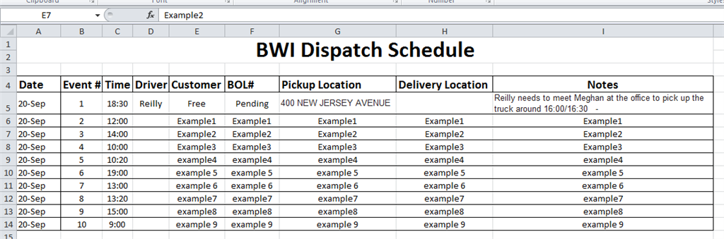

I need Excel to auto sort smallest to largest descending and pull other cells to the new location as a new time is entered.
In detail:
Column C is time of day for a specific event (in military time) beginning on Row 5.  When a user enters a new event and assigns a time to it, I need that corresponding information to sort into the correct event row.  Below is a capture of the worksheet.
So for instance; The data entered for Event #10 beginning with Cell C14 and ending with Cell I14 would need to move to the row for Event #1 (Cells C5 to I5).  So basically I just need Columns "C" through "I" beginning on row 5 to auto sort based off of the time entered in column C so that the proper Event # is met based off of the time of day that it occurs.  I believe this requires a Macro but I am unfamiliar with those.

    Let us take your example: You have at least three possible times to consider if somebody needs to meet another person in order to pick up something:
    1. The time you get the idea and you enter this (entry time)
    2. The time Reilly has to meet Meghan in the office
    3. The time the truck has to be picked up
    So why should the event time be 18:30 when the (obviously most important) pick up time is 16:00 - 16:30? Maybe you need to take date and time, not just time?
    Which is really the driver for the event time? Should this example have two entries (Reilly needs to meet Meghan in the office, and Reilly needs to pick up the truck)?

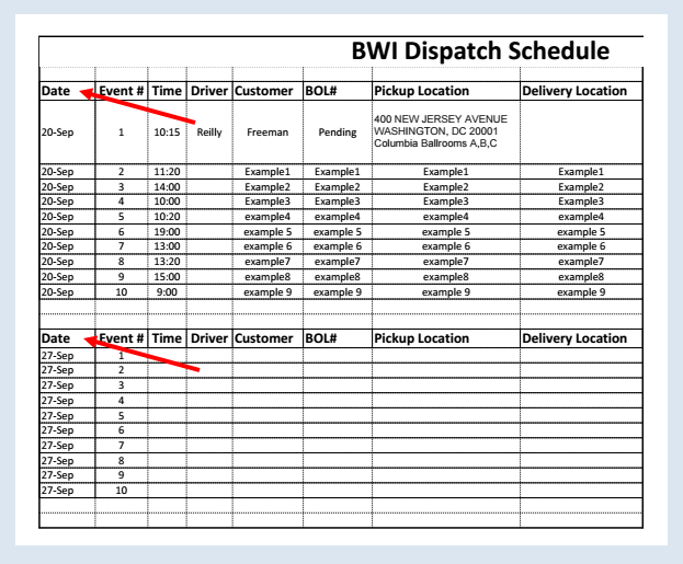

    select 'Date' in column A and press double click
    in order to sort data in the specific section
    (sort by column C, Time)
    1st section A4:I14
    2nd section A17:I27
    ect.....

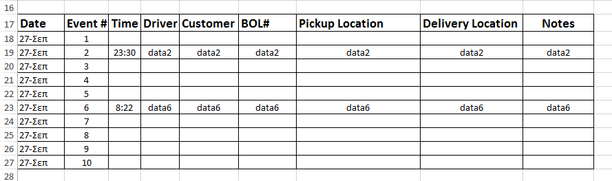

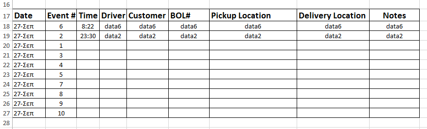

    1. before (double click in cell A17)
    1. result
    1. result
    This works perfectly except I need to exclude Column B from this sort, is that a possibility?
