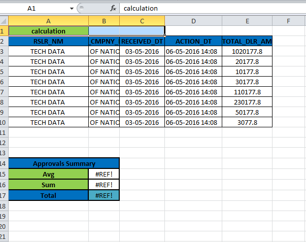

Hello,
i am creating a  macro that would copy all the data from sheet 1 and paste it below the blank row of sheet 2 .
                                Sheet 1 has 2 tables calculation and Approvals Summary. Below is the pic of Sheet1

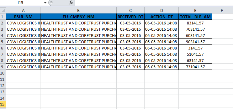

                 Sheet 2 has some data in it. Below is the pic of sheet 2
I want to copy both the tables from sheet 1 and paste it below the blank row of sheet2.
So ,I tried to copy all the data in sheet 1 by using Cells.Select . I am able to copy it but not paste the data in sheet 2.

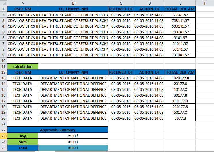

    Hello Tasosk,
    Thanks for your reply!
    I tried it but it is pasting both the sheet data together  and for Approvals Summary only the avg and sum is pasted not the entire table.  Below is the pic.
    Want i want to do is copy both the tables (calculation and Approvals Summary) from sheet 1 and paste it below the first blank row of sheet2.   Below is the pic of the result which i am asking for.
    but how do i do this ?
    Regards
    Wither
    2016-05-22T15:59:15+00:00
    Hello Tasosk,
    Its working perfectly ! Thank you so much (:-) (:-)
