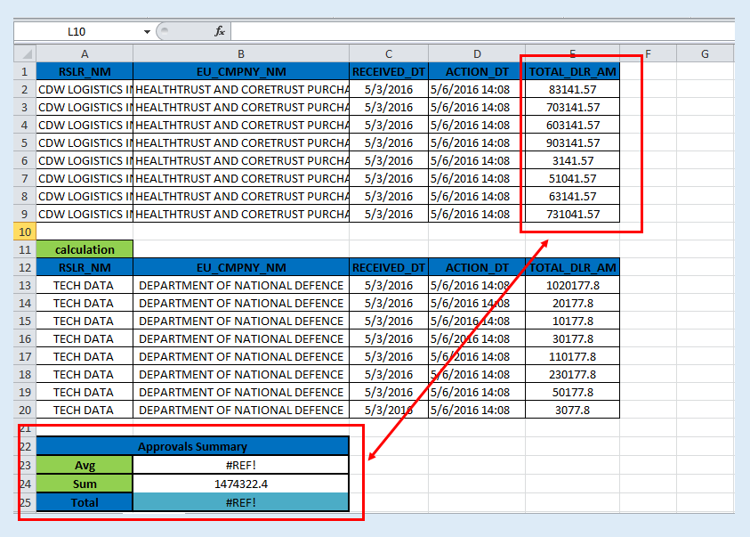

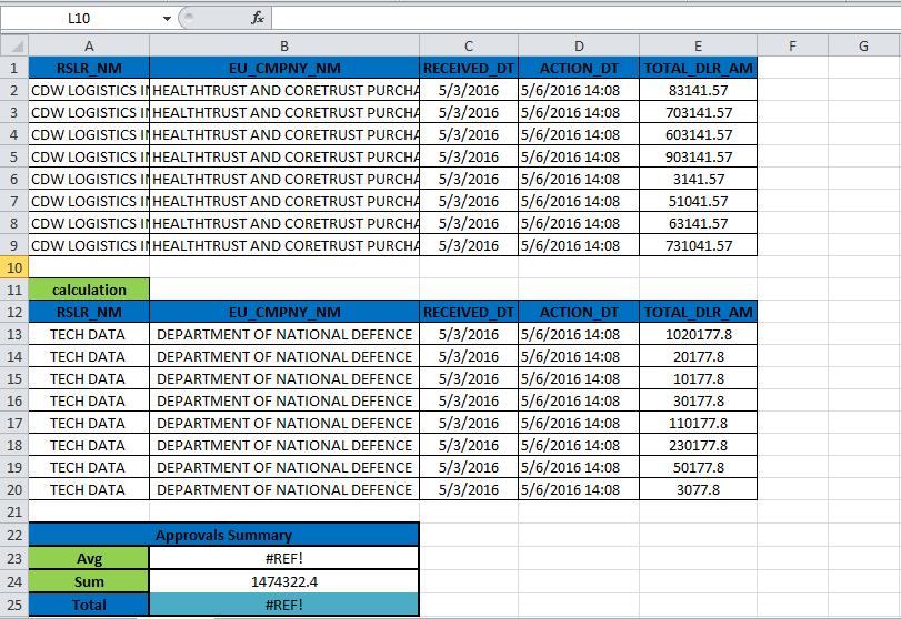

Hello,
i am creating a  macro that would copy all the data from sheet 1 and paste it below the blank row of sheet 2 .
                                Sheet 1 has 2 tables calculation and Approvals Summary. Below is the pic of Sheet1
                 Sheet 2 has some data in it. Below is the pic of sheet 2
I want to copy both the tables from sheet 1 and paste it below the blank row of sheet2.
So ,I tried to copy all the data in sheet 1 by using Cells.Select . I am able to copy it but not paste the data in sheet 2.

    2016-05-22T16:30:56+00:00
    Hello Tasosk,
    Could pls help me with this and let me know that were i am going wrong.
    I am calculating the sum from the column(TOTAL_DLR_AM) of the first table and pasting the calculated sum in the row named Avg of the table (Approvals Summary) . i am able to do this, but the problem is that its calculating up to the next row of the  table (calculation).
    I want to calculate only the data from the first table of the column(TOTAL_DLR_AM) and not from the calculation table.
    Below is the code:
     Windows("c250k.xlsm").Activate
        With Sheets("Sheet1")
        myRow = .Range("E" & .Rows.Count).End(xlUp).Row
        rSum = Application.WorksheetFunction.Match( _
        "Avg", .Columns(1), 0)
        .Cells(rSum, 1).Offset(, 1).Formula = "=SUM(E3:E" & myRow & ")"
        .Columns().AutoFit
        Range(Selection, Selection.End(xlDown)).Select
        Selection.Copy
        Selection.PasteSpecial Paste:=xlPasteValues, Operation:=xlNone, SkipBlanks _
            :=False, Transpose:=False
        Application.CutCopyMode = False
        End With
    Thank You!
    Regards
    Wither
    2016-05-22T16:48:30+00:00
    data in activesheet
    based on the below pic.
    try this...
    Sub Formula_Avg_Sum_Total()
    'May 22, 2016
    Dim ws As Worksheet
    Set ws = ActiveSheet ' << or  Sheets("Sheet1")  / change as needed
    Dim r1 As Long, c1 As Long, r As Long
    r1 = ws.Range("A1").CurrentRegion.Rows.Count
    c1 = ws.Range("A1").CurrentRegion.Columns.Count
    r = ws.Cells(Rows.Count, 1).End(xlUp).Row
    Dim sLet As String
    sLet = UCase(Left$(ws.Cells(1, c1).Address(False, False), Len(ws.Cells(1, c1).Address(False, False)) - 1))
    ws.Cells(r - 2, 2).Formula = "=AVERAGE(" & sLet & "2:" & sLet & r1 & ")"
    ws.Cells(r - 1, 2).Formula = "=SUM(" & sLet & "2:" & sLet & r1 & ")"
    ws.Cells(r, 2).Value = ws.Cells(r - 2, 2).Value + ws.Cells(r - 1, 2).Value
    ws.Cells(r - 2, 2).Resize(3).NumberFormat = "0.00"
    End Sub
    2016-05-22T19:27:42+00:00
    Hello Tasosk,
    Thanks for your reply ! The above code is working.
    But when i run it in other worksheet its calculating the Column H (TAT) of the first table ,so how do i change it to column G.
    I want to calculate the column G of the first table.
    Also, can u pls tell what the below code means.
