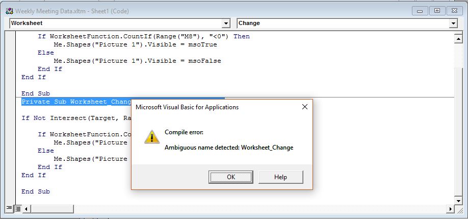

Hello,
i'm trying to have some hyperlinked images on a Worksheet which can only be seen on the case if the referenced cells value is negative. this image will then appear and hyperlink to somewhere else.
i managed to successful do that with a couple of cells with image "Picture 1" and it's working perfectly. the issue happens when i try to add another image to the worksheet "Picture 2" and assign it to different cells. somehow the code doesn't work.
here is the code i'm using:
Private Sub Worksheet_Change(ByVal Target As Range)
If Not Intersect(Target, Range("K8")) Is Nothing Then
    If WorksheetFunction.CountIf(Range("M8"), "<0") Then
        Me.Shapes("Picture 1").Visible = msoTrue
    Else
        Me.Shapes("Picture 1").Visible = msoFalse
    End If
End If
End Sub
If Not Intersect(Target, Range("K14")) Is Nothing Then
    If WorksheetFunction.CountIf(Range("M14"), "<0") Then
        Me.Shapes("Picture 2").Visible = msoTrue
    Else
        Me.Shapes("Picture 2").Visible = msoFalse
    End If
End If
End Sub
here is a screenshot from the error. can someone help?

    2016-09-15T00:59:25+00:00
    Can't have two events of same type in same worksheet.
    Try something like this. . . . .
    Place the event code in the worksheet module and macro1 and macro2 in a regular module.

    2016-09-15T12:37:26+00:00
            macro1
        ElseIf Not Intersect(Target, Range("K14")) Is Nothing Then
                macro2
        ElseIf Not Intersect(Target, Range("P8")) Is Nothing Then
                macro3
        End If
    End Sub
