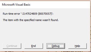

    2016-09-15T23:47:04+00:00
    When I made a change in the third sheet, then it updates the first sheet and you get the error because the activesheet is the third sheet.  If you make this change to your code it works:

    2016-09-15T23:56:37+00:00
    Three problems. . . . .at least<g>
    1.  Take Macro1, 2, 3 out of Sales Sheet Module and place in a General Module.  Leave sheet
    modules for sheet event code.
    2.  You have a second unrelated Macro1 and some event code in InputData Sheet Module
    Move that macro to a General module and rename it to something other than Macro1
    Or just dump that if you don't need it.
    3.  There is no sign at all of any code for Picture 7 which is OK because there is no Picture 7 in the
    workbook you posted.
    I have uploaded the workbook to this site. . . . . .

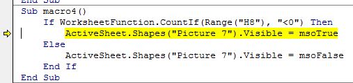

    2016-09-15T18:49:18+00:00
    ok, i feel stupid :D. i fixed that but i hit another error. this error happens when i try to input the date in another sheet cells which will then use that last code to reflect on "Sales" sheet.

    2016-09-15T19:39:29+00:00
    Hard to keep track of your changes.
    Are you sure that Picture 7 is a shape on the ActiveSheet
    Suggest you could upload your workbook to a file-sharing site then post the URL of that site.
