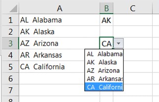

    The only thing I can think of would be to include both in your lookup column, formatted like:
    AL  Alabama
    AK  Alaska
    AZ  Arizona
    AR  Arkansas
    CA  California
    Use Data Validation to point to this list (I'm assuming you are doing this on a worksheet and not a userform, but you didn't specify)
    Then shrink the column width so that only the first two letters show, but when you click the cell the DV downarrow will still appear, and you will still be able to see the state names.
    If you need just the left two characters for some other purpose (vlookup, match/index, etc.) then just wrap the cell reference in a LEFT formula
    =LEFT(B1,2) to get the 2-digit ID <- this goes in the cells referencing this one, not the DV cell itself
    You may want to add a single spacebar (blank char) in the cell to the right of your DV cell, so the full value doesn't show across unused cells. Also, if the DV box isn't wide enough- in my test case, I couldn't see the last few chars of "California" but I could see enough.

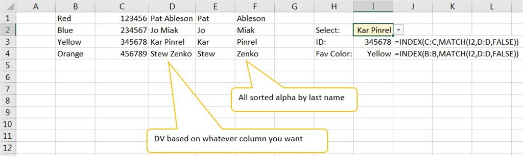

    Alternatively, if you are willing to have a slightly less perfect interface, you could use two different cells, where one cell is the DV lookup, and the other then takes the selected value and returns the ID. Depending on your usage, this isn't so bad- you can bring back more than just the ID if you want (tenure, last performance rating, boss, company email address- whatever you have in your table)

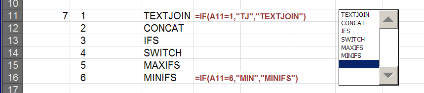

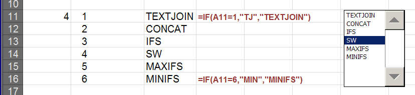

  5. Anonymous
    2017-11-09T20:17:31+00:00
    Laurie,
    re: alternate display of selection
    Another way...
      Jim Cone
      Portland, Oregon USA
      https://goo.gl/IUQUN2   (Dropbox)
      (free & commercial excel add-ins & workbooks)
