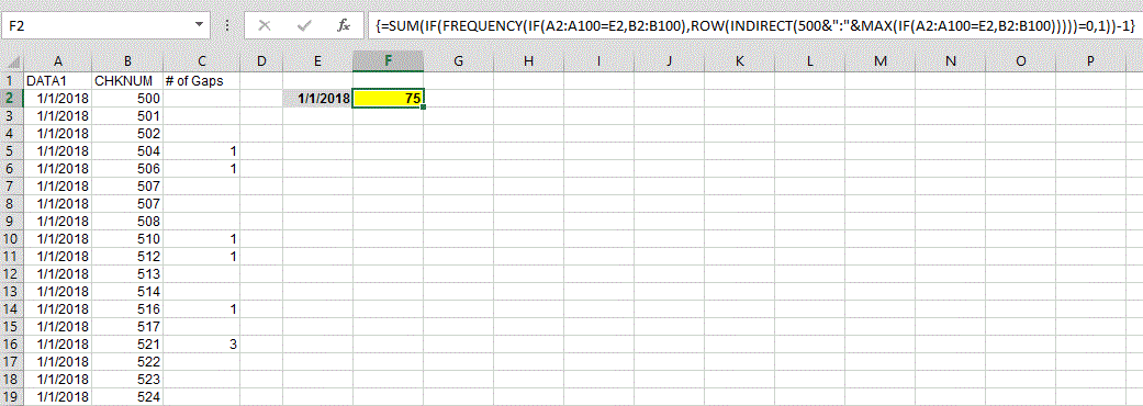

    Enter below formula as an array formula (Ctrl+Shift+Enter) in cell F2:
    =SUM(IF(FREQUENCY(IF(A2:A100=E2,B2:B100),ROW(INDIRECT(500&":"&MAX(IF(A2:A100=E2,B2:B100)))))=0,1))-1
    This will give the count of missing numbers for the relevant date (E2).
    You may download the excel file from below link wherein this has been illustrated:

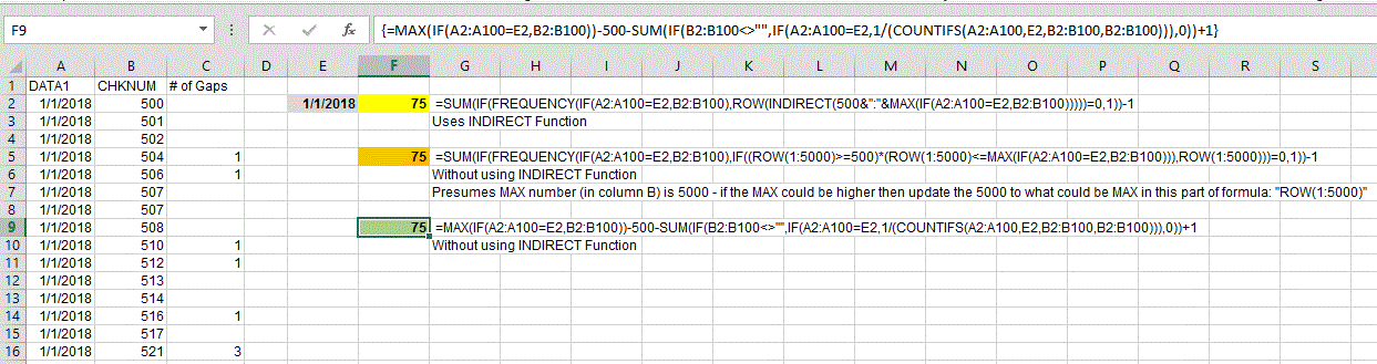

    The above formula uses INDIRECT Function. Below option can also be used which avoids using INDIRECT:
    =SUM(IF(FREQUENCY(IF(A2:A100=E2,B2:B100),IF((ROW(1:5000)>=500)*(ROW(1:5000)<=MAX(IF(A2:A100=E2,B2:B100))),ROW(1:5000)))=0,1))-1
    This formula Presumes MAX number (in column B) is 5000 - if the MAX could be higher then update the 5000 to what could be MAX in this part of formula: "ROW(1:5000)". So if MAX in column B could be 10000, then update to "ROW(1:10000)".
    If you use INDIRECT as mentioned in the previous reply, then no updation is required.
    Both options are given in the excel file uploaded earlier.

    The first 2 options (cell F2 & F5) have already been mentioned earlier. There is also a 3rd option: enter below formula as an array formula (Ctrl+Shift+Enter) in cell F9:
    =MAX(IF(A2:A100=E2,B2:B100))-500-SUM(IF(B2:B100<>"",IF(A2:A100=E2,1/(COUNTIFS(A2:A100,E2,B2:B100,B2:B100))),0))+1
    The first option uses INDIRECT, which is a volatile function and it increases processing time & slows down workbook if used in a large number of cells.
    In respect of the other formulas also, because of the large number of cells and the formulas being somewhat complex, you are experiencing the extra processing time ... you may try the latest (3rd option) in case that may work faster.
    Note: The formulas have also now been illustrated in the same excel file (whose link was given earlier).
