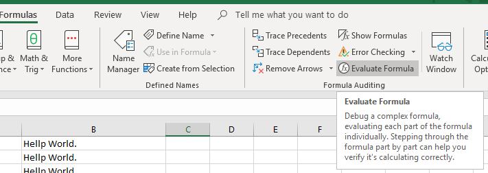

    In the meantime, Evaluate Formula feature might be also helpful for checking the process.
