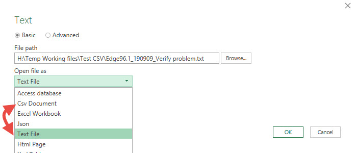

    My colleague just worked out a solution, change the Open file type from csv to Text. It now opens all lines. Then just add in a split column step.
    So the problem is just with csv file type.

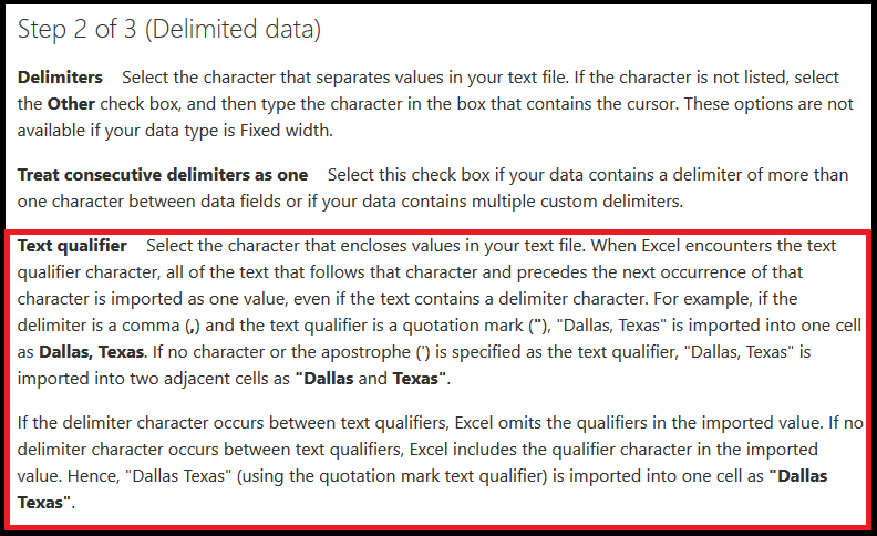

    After consulting, I would like to explain that the issue (double quotes without endings in the imported txt file caused import failure) may be an expected behavior. Please refer to this article: Text Import Wizard.
    This means when we try to import text (includes .txt and .csv) to Excel, Excel will try to find another quote " to determine which format will the contents (wrapped in double quotes) displays. But it cannot find another quote " so it doesn't know how to display the contents behind the first quote ", hence the error.
    Besides, would you mind sharing the detailed steps of the solution your colleague found? Since we haven't tested import the CSV file to Excel, I'm not sure what the "change the Open file type from csv to Text" means and what did you do to change the format.
