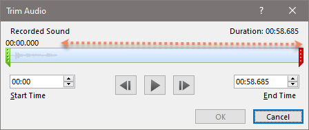

    2020-02-18T14:47:12+00:00
    I think you will find that most of the sound files have a long quiet section at the end. The transition will wait for this to play (silently)
    Look at the sound in the Trim editor, the area with the arrow is just silence for nearly a minute. Use the trim tool to remove the blank section and it should work (I did a couple of slides to confirm)
    http://www.pptalchemy.co.uk/Downloads/Consumer Sales Pres_Video Setup.pptx
