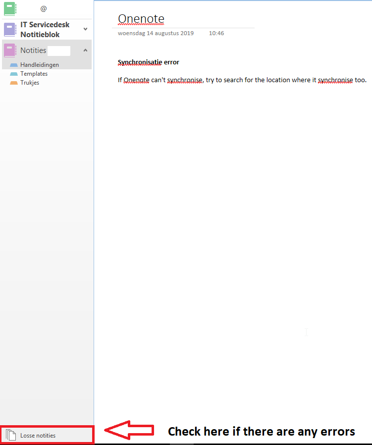

    I found a solution for this problem!
    I had a user that had the exact same problem.

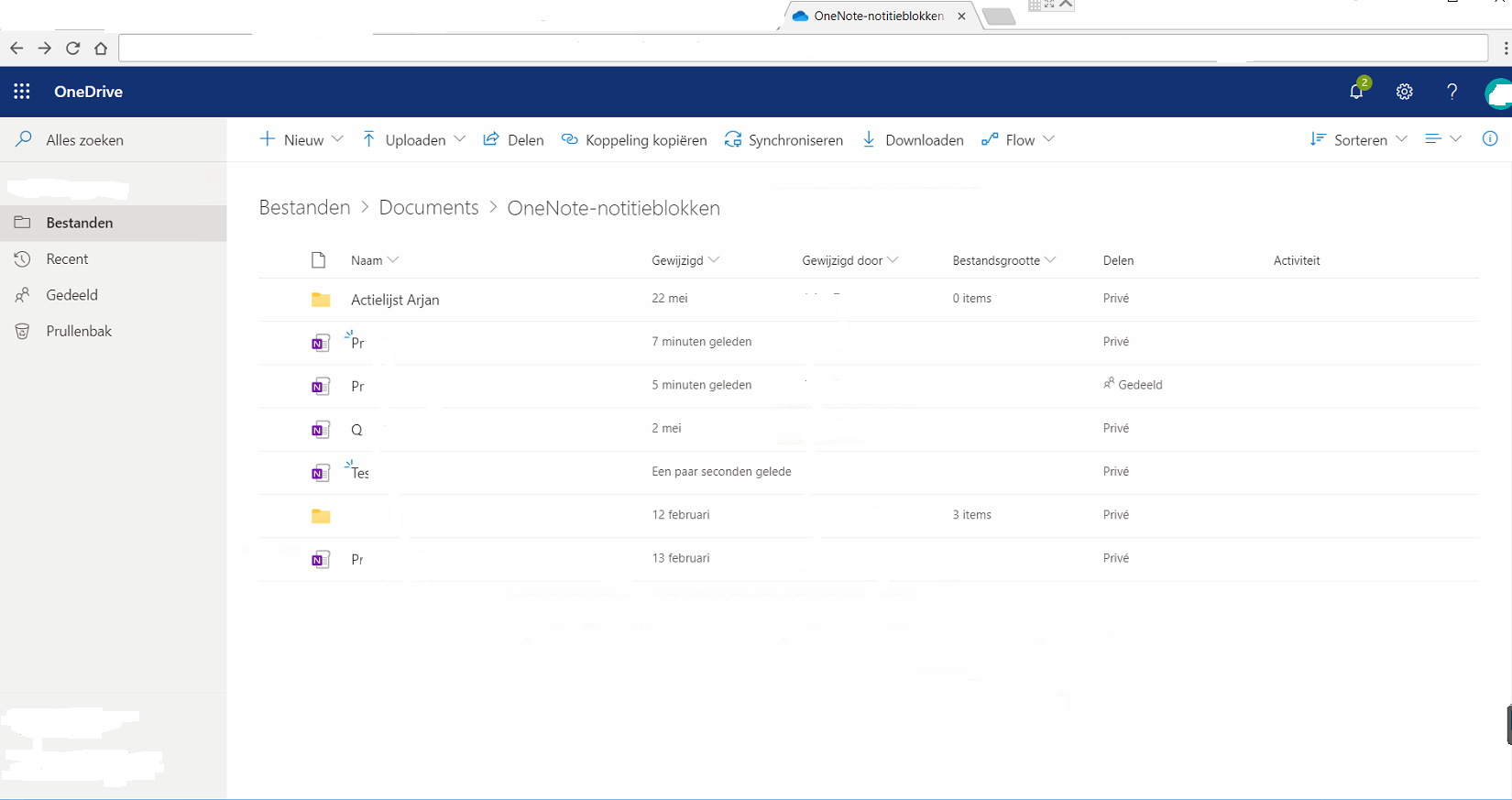

    The solution is to take a look into the onedrive location he is syncing to:
    Check if there are any files that aren't in the onenote it self. Delete all the files you don't need anymore(which are already deleted out of the onenote application).

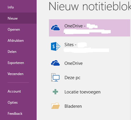

    Also check if the user is syncing to the right location, i saw that the user i helped synced to wrong location, he synced to the local onedrive sync which is weird and onedrive can't handle this or onenote of course.
    The user i helped had the problem that he choosed this pc and then he directed to the onedrive that was synced to the local pc!
    The last step that you could try is this:
    If you see any errors here delete them, these are probably pages that go previously deleted or aren't needed anymore, or are broken!
