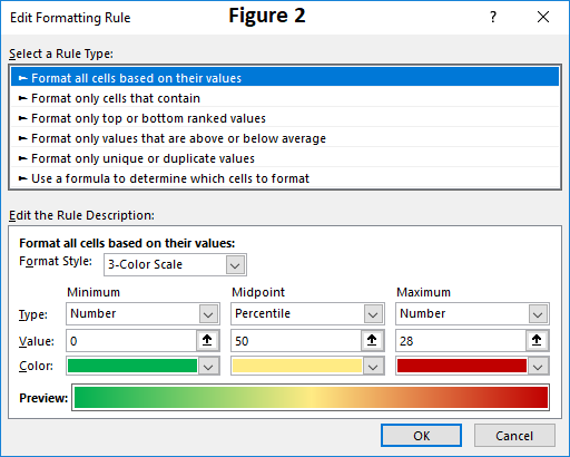

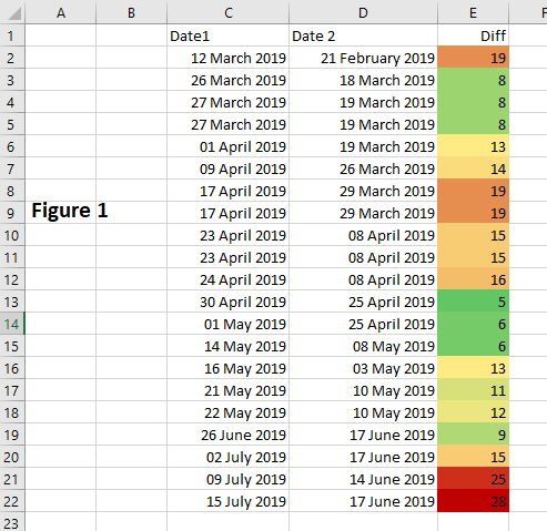

    Thank you for your reply. However, let me explain a bit more with the following screenshot (Figure 1). For the Diff column, I have used the conditional formatting rule in Figure 2. My aim is to get the same kind of color grading (not just three colors but graded colors) for column D as E without using the Diff column at all.

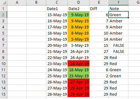

    You are doing right to use distinct rules for 3 conditions. You need to specify clearly each rules with AND() so that Excel can identify what values exactly to format. like this:
    For <7 Days:
    • Select D2:D15 cell.
    • Go to: Home | Conditional Formatting | New Rules
    • Apply this formula and Select Green Color: =(C2-D2)<7
    • Click Ok
    For <14 Days:
    • Again Go to: Home | Conditional Formatting | New Rules
    • Apply this formula and Select Amber Color: =AND((C2-D2)>=7,(C2-D2)<=14)
    • Click Ok
    For >28 Days:
    • Apply this formula and Select Red Color: =(C2-D2)>28
    • Click Ok
    Hope this will help you.

    I hope this explanation makes my requirements clearer. I am currently using a method similar to what Faysal had suggested and this gives me three distinct colors for my Date 2 column. For this, I have three separate rules for which I use the rule type "Use a formula to determine which cells to format".
    However, I want graded color scheme (not three distinct colors but different shades proportional to deviation from colors allocated for minimum and for maximum values) for my Date 2 column. In Figure 2 above, the graded color scheme has been applied to the Diff column by using 3-color format style under the rule type "Format all cells based on their values". Is there a possibility that I can apply such a rule type and 3-color format style on the Date 2 column?
    If there is a way to match the color of Diff column cells in the respective cells in Date 2 column, that will also meet my requirement.
