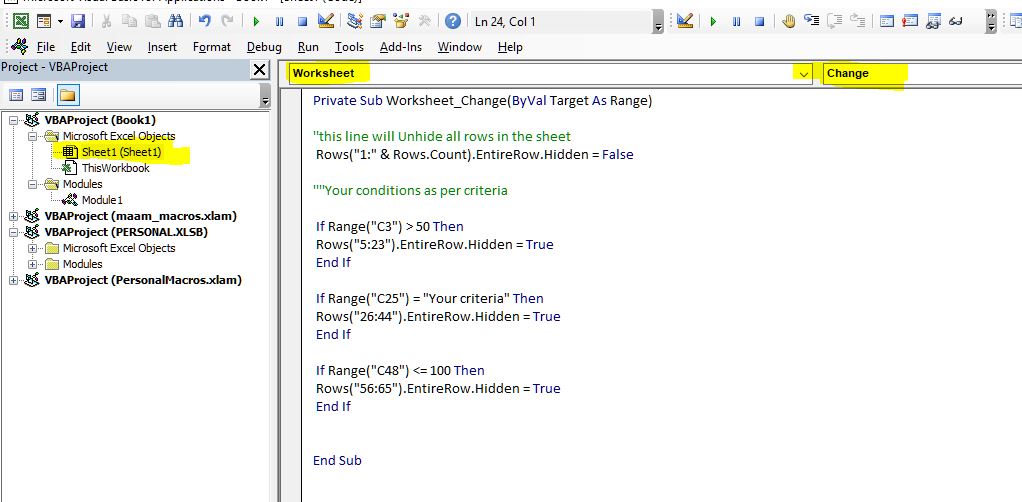

    This is the code for the Worksheet Private event
    Private Sub Worksheet_Change(ByVal Target As Range)
    ''this line will Unhide all rows in the sheet
     Rows("1:" & Rows.Count).EntireRow.Hidden = False
    ''''Your conditions as per criteria
     If Range("C3") > 50 Then
     Rows("5:23").EntireRow.Hidden = True
     End If
     If Range("C25") = "Your criteria" Then
     Rows("26:44").EntireRow.Hidden = True
     End If
     If Range("C48") <= 100 Then
     Rows("56:65").EntireRow.Hidden = True
     End If
    End Sub
    Check picture below
    Do let me know if you require any further help on this. Will be glad to help you.

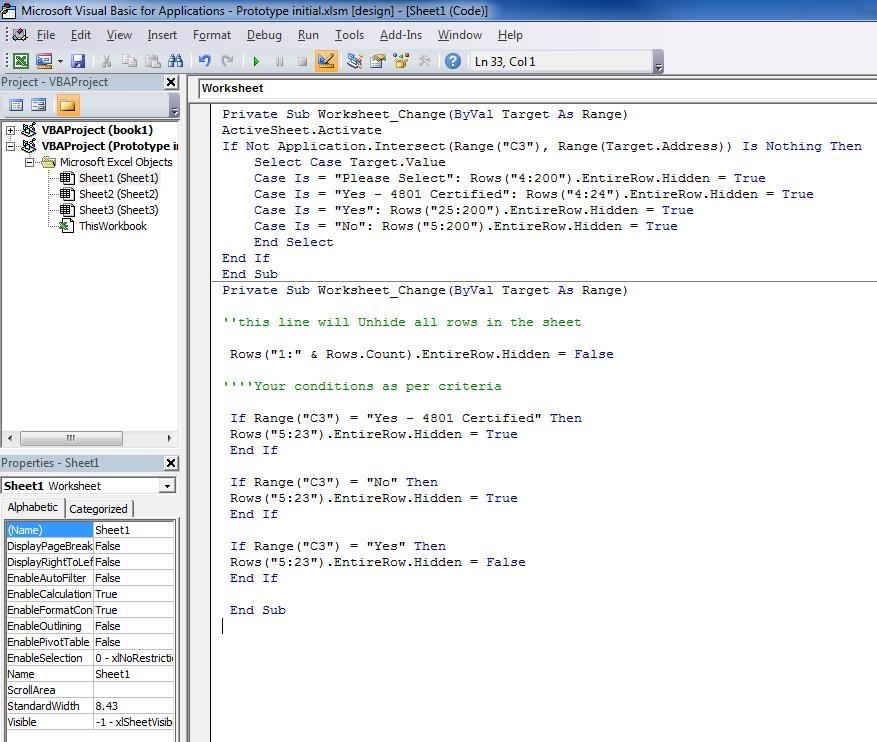

    I'm also getting a privacy error when trying to save? This is what I entered based on my understanding of what you sent earlier:
    Thank you very much for your help with this.

    Regarding the error I'm not sure if  2 Worksheet_Change(ByVal Target As Range)
    events can be at the same time (same module) in a worksheet.
    I think is better create a module place the two macros in it and then call them from the procedure
