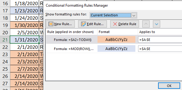

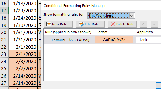

I'm using a simple formula in conditional formatting to shade rows greater than today =$A2>TODAY()
For the most part it is working as expected. However, I have two rows with today's date (2/1/2020) - the format is applied to one of the rows but not the other.
To troubleshoot I selected a random cell and did =TODAY() to check the date excel is registering as today. The result was correct 2/1/2020

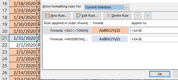

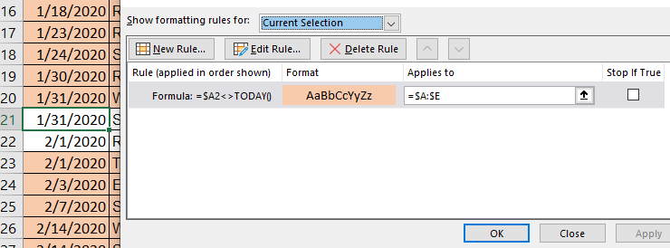

I then did a conditional format for <>TODAY() and the format was applied to all rows except one of the 2/1/2020 rows and a row with 1/31/2020!
Additionally, when I tried changing some of the dates which did not have the formatting to later dates, instead of shading the row I changed, the format was applied to the row above it.
I removed other formatting which had been applied to ensure this was not interfering. I haven't had any luck searching for potential solutions.

    Since the rule is applied to entire columns, the formulas should use $A1 instead of $A2.
    Using $A2 causes the formatting to be shifted by one row.
    2020-02-01T17:00:56+00:00
    When I changed it to $A1 it then applied the formatting to all of column B
    2020-02-01T17:02:48+00:00
    Applying this formula has the same results as my post.
    2020-02-01T17:04:57+00:00
    Right formula should be (don't keep $)
    =A1<>TODAY()
