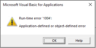

    2020-07-06T17:02:47+00:00
    Your error handling is allowing you to skip over code problems. You might want to disable it temporarily by placing a ' at the beginning to comment it; e.g. 'On Error GoTo xxxxx. That will show you what error is being produced.
    If you are not willing to do that, open the VBA editor's Immediate window with Ctrl+G. Type or paste in one of these code lines and tap Enter.
    ?Range("VendorNameFirst:VendorNameLast").Address(0,0)
    ?Range("VendorNameFirst").Address(0,0)
    ?Range("VendorNameLast").Address(0,0)
    You are almost assuredly going to receive the following error. This is the error code and description I mentioned earlier.
    There are a limited number of reasons for this error. Following are the three most probable.
    • You've simply mistyped VendorNameFirst and/or VendorNameLast. Double-check Formulas, Defined Names, Name Manager to make sure they are what you expect them to be.
    • You defined the two named ranges with worksheet scope but are using them when another worksheet is active. Again, this can be checked in the Name Manager. If this is the case, you need to define the proper parent worksheet of the Range object. For example:
    Worksheets("Vendors").Range("VendorNameFirst:VendorNameLast").Insert  Shift:=xlShiftDown
    In a public module code sheet, a Range object without a specified parent worksheet always belongs to the ActiveSheet and you cannot define a range on the active worksheet using defined names that belong to another.
    • You're using the code in a worksheet's private code sheet and not a public module code sheet. Further, VendorNameFirst and/or VendorNameLast are not in the worksheet where you are writing the code. Again, you need to specify the parent worksheet (see code above). In a worksheet's private code sheet, a Range object without a specified parent worksheet always belongs to that worksheet and you cannot define a range on one worksheet using defined names that belong to another.
    Those debugging methods should cover your problem. If not, report back actual error codes and named range status.
