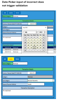

    2020-07-12T11:38:56+00:00
    Hi Madoc,
    Thank you for getting back to me.
    Yes this is related to VBA, I have included some screenshots.
    If I manually input an incorrect date the validation gets triggered.
    If the Date Picker inputs an incorrect date the validation does not get triggered.
    If you need more information please let me know.

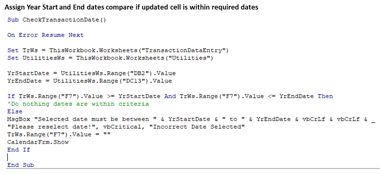

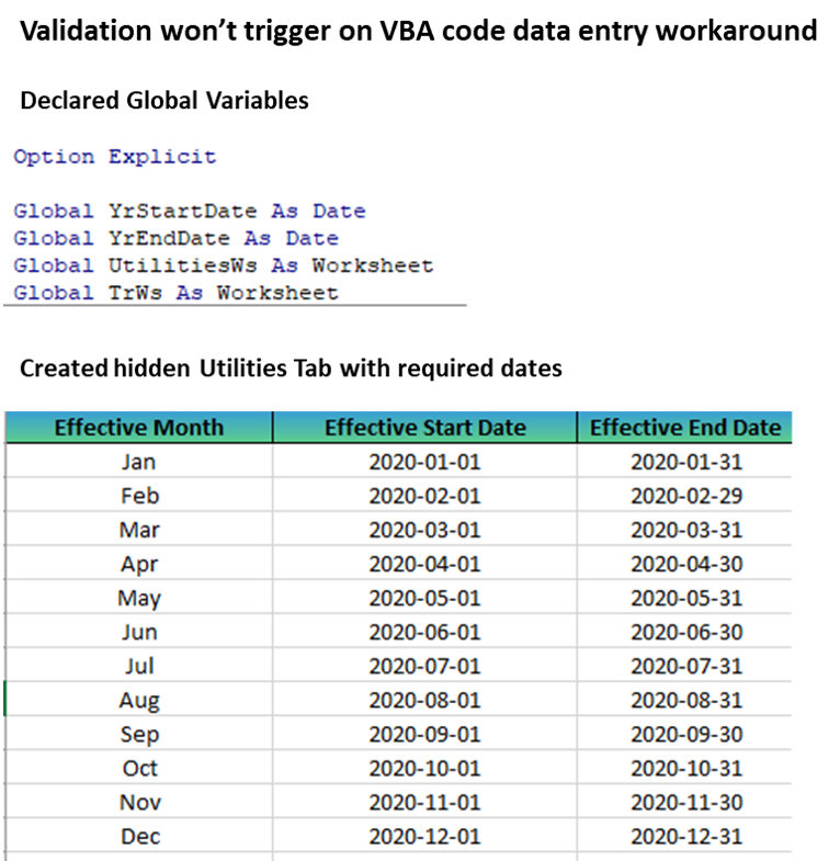

    2020-07-13T10:59:26+00:00
    Hi OssieMac,
    Thank you very much for the confirmation of my suspicions on the Validation Trigger and you offer to assist with the workaround code.
    I was able to create a work around that I would like to share with the community.
    Regards,
    Perry
