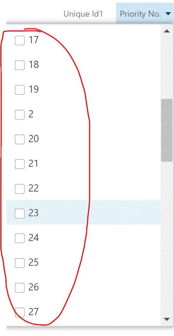

When one of the 48 projects is completed, I can change the category from "Prioritized" to "Complete" in the list (the column created is a "choice" and a "drop-down" list to change the category easily).  The item in the list changes to "Complete", and the prioritized number is now reassigned to the next project in the list, and so on.  The problem I have is, the numbers in the Priority No. column display in this following order:
  • 1, 10, 11, 12-19,
  • 2, 20, 21, 22, 23, 24, 25-29,
  • 3, 30-39,
  • 4, 40, 41-48,
  • followed by a group projects without a priority number (which is accurate)
  • then projects with priority numbers 5-9 appear at the bottom of the list
This is incorrect.  I need the priority numbers to appear in numerical order (1-48) and at the top of the list, followed by the group of projects without a priority number.  I have added a few screenshots below to describe the issue better.  Any assistance you can provide will be greatly appreciated.  Thank you in advance.

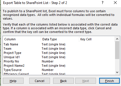

    After referring to the Excel workbook provided by you, we have done several tests by exporting the Excel table to a SharePoint list, we can reproduce the similar behavior at our end. So, we tried narrowing down the problem from the start i.e. with the Excel file only with Priority No column.
    Methods tried at our end: (as the problem happens only with the Priority Number column and no problem with the Type/Source column, we took both columns as reference for finding the cause of the problem)
    Method 1:
    1. Tried to copy the Priority No column and Type/Source column to a new workbook and insert a Table.
    2. Tried to export the table as a SharePoint list.
    3. Found that Type/Source was converted it as a Number type column and Priority No was converted as a Text (Single line) type column.
    1. So, based on the Key Cell reference for the Priority No column, tried to fix the cell but still we are not able to convert the column format from Text (single line) to Number column.

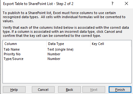

    Method 2:
    1. As we can’t work by pasting the copied content normally, we used the Paste Special feature and utilized the Paste as Values feature for pasting the content (Priority No and Type/Source column).
    2. Pasted the Priority No column as Text.
    3. So, we converted each cell that which displays values as text to number.
    4. After converting the values to numbers for the Priority No column, we tried to export the table as a SharePoint list.
    5. During the export, we found the Priority No column is converting as a number.

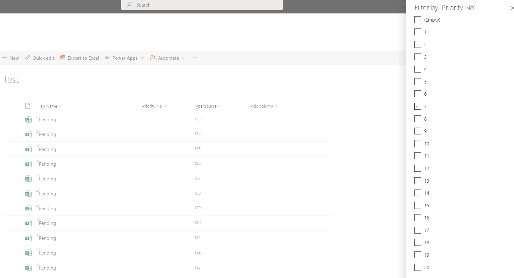

    6. After clicking on the Finish and accessing the created SharePoint list in SharePoint Online, Filter by shows the correct result:
    Based on our test, we can conclude this problem is caused due to the wrong data format in Excel workbook. In this case, we request you copy the complete Priority No column and paste it as values in the new Excel workbook. After pasting, convert each cell as numbers manually and check whether column is converting as a Number type. If yes, copy the Priority No column in the new workbook and paste it in the place of problematic workbook.

    5. I created a custom list app (from Excel) - chose "Export table to SharePoint List" and entered the URL of the SharePoint site.
    6. I reviewed the columns and the data types (in the 2nd step of the "Export Table to SharePoint List") - everything looked correct to me.
