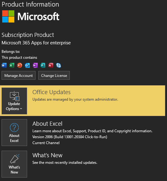

- Though, for all I know, it could be the Excel Client that is causing my issues, I am experiencing them in Excel Online

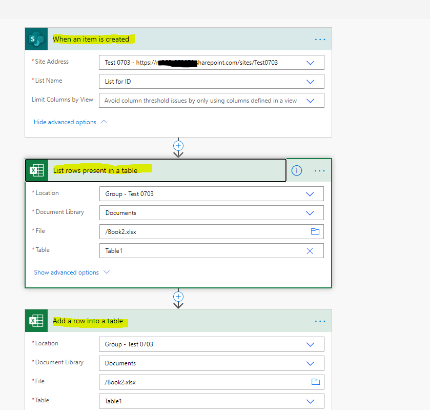

- Could you provide the detailed steps about how you used Power Automate Flow to add formulas?
I am gathering 7 pieces of data in one form:
- Auditing Office
- Office Being Audited
3-7. ID numbers to identify certain records to be audited

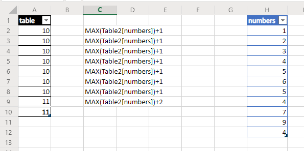

I am taking this data and creating 5 rows in Excel, one for each of the ID numbers; each line gets the same Auditing Office and Office Being Audited data. I am attempting to create a unique ID for each of these lines. Starting out with the larges number recorded, I am adding 1 to it for the row in with the first ID, 2 for the row with the 2nd ID, and so on for all five rows. Obviously, these formulas are very similar, but slightly, and vitally, different. As each formula is added, all previous formulas are overwritten with whatever the last formula is, rendering my work useless.
Each time one of these rows is created, I am creating a duplicate of that row in a table labeled "Log." Doing so records the unique ID, in this case "Data ID," into the log accurately. Interestingly, and in this case, usefully, adding this cell into the Log records teh static number, and does not record the formula, something I wish to learn how to intentionally accomplished for future use.
- No, it does not seem to be repeatable from my end. I wonder if, because that horribly rude setting, "Extend data range and formulas," has been turned off in my client, that, in the online version, that setting sticks?
Between rows 9 and 10 there is a visual queue that I do not recognize from the other document, specifically, the double horizontal line between the established table and the new entry in row 10.
