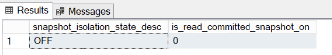

    The other answer...
    SELECT snapshot_isolation_state_desc, is_read_committed_snapshot_on
    FROM   sys.databases
    WHERE name = 'Kelso-Powerapps'
    Results:

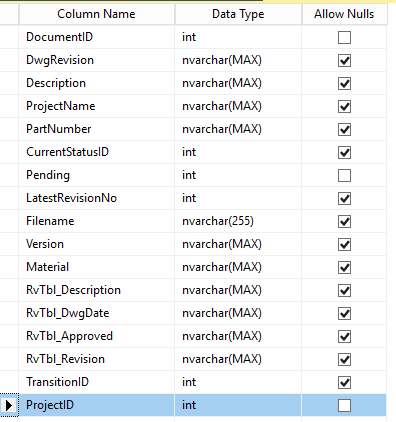

    It takes 8 seconds to run in SSMS. However, if I search for DocumentID... the result is almost instant!! Either in the VIEW, or the TABLE. THe difference? It may not be a surprise for you, because you know what you are doing. But, DocumentID is an int, and PartNumber is a nvarchar(max). So, I can remove the VIEW aspect of this entirely, and still have the problem. From this, I have two questions.
    1. What is the expectation of what would be a measurable "congestion" for this if its just a simple table? In my mind.. SQL is designed to serve a very large concurrent user base. So, I would hope that it would work without a huge degraded performance situation, even if it had say 20, 50, or even 100 concurrent hits. Is that not what SQL is designed for? Large datasets with lots of users and concurrent hits? Also note, I did not index anything in the TABLE version of this dataset either.
    2. Is there a better way to query for string variables? In my case, I am searching for an exact match. Not a partial match. So, when I want '501029X', that exactly what I want. In every case. I dont konw that I can change the type in a VIEW, but is there a better type for performance for a string variable? It does make sense to me that integers are much faster... but not by that much. Comparitively speaking. SSMS reports '0' seconds for the DocumentID search result, and '8' seconds for the PartNumber result.

  3. Rod Martin 136 Reputation points
    2021-08-13T19:24:19.74+00:00
    @Jeffrey Williams ,
    I can do that for my table. But how to change the type of my existing view? Thats the issue. Also, i cant key it. As far as i know. I havent been given a method that works. I get an err about the view not being... uhh. I forget the term now. But its earlier in this thread.
    The partnumber field will never be more than 16 characters. But how can i change that? Same issue. Pkease peovide method, and ill gladly try it.
    Properties of all columns in my view say indexible 'no'.
