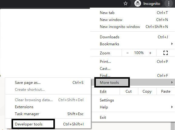

    2. On Chrome browser, open Settings -> More tools -> Developer tools.

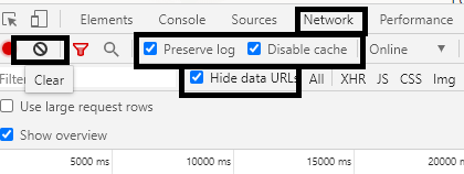

    1. In Network tab, select “Preserve log”, “Disable cache”, “Hide data URLs”, then click “Clear” icon to clean up all existing session entries:

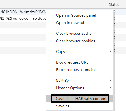

    2. After issue reproduced and error emerged, right-click session pane and select “Save all as HAR with content
