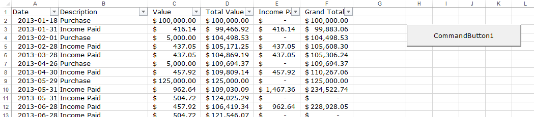

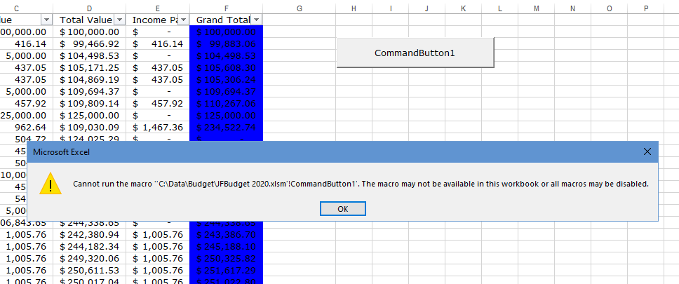

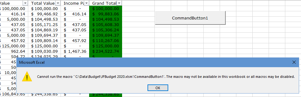

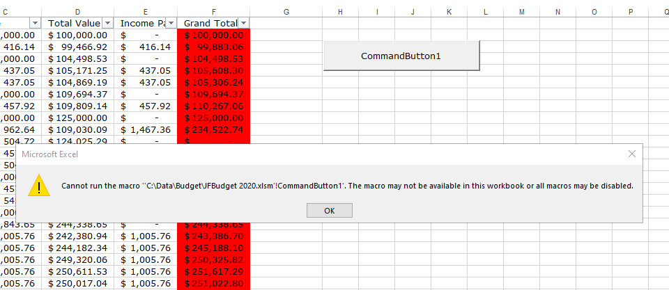

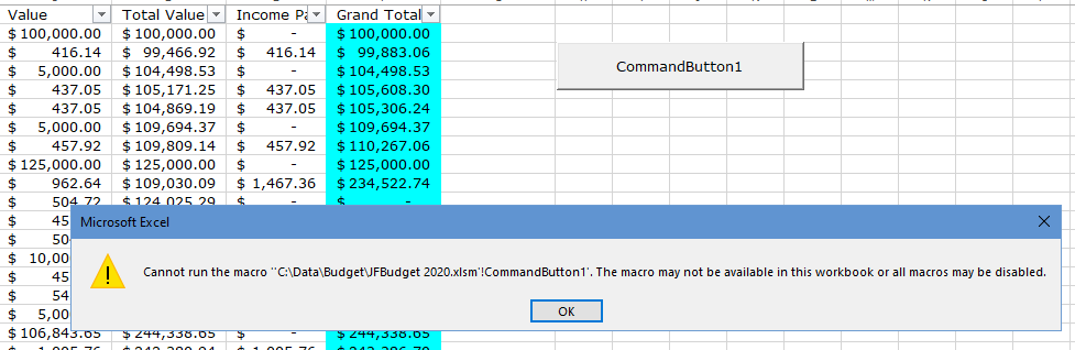

I have VBA code to make Column F to blink

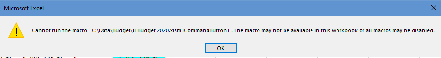

  1. When I click on macro I can't see CommandButton1
  2. I have an error code
  3. I click OK and the macro starts running with the below error and I have to repeat that action 5 times
  1. My macros aren't disable

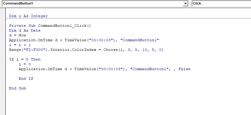

VBA Code
When I click on command button Color 3 and I click OK and run the command button again
Color 8
Color 10
Color 5
Color 0

  1. HansV 462.4K Reputation points MVP Volunteer Moderator
    2020-02-24T20:23:04+00:00
    CommandButton1 is the name of a command button, it is not a macro. Hence the error message.

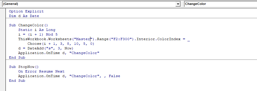

    1. Select Insert > Module in the Visual Basic Editor to create a standard module.
    Copy the following code into it, and change Sheet1 to the name of the worksheet for which you want to toggle the color.
    Dim d As Date
    Sub ChangeColor()
        Static i As Long
        i = (i + 1) Mod 5
        ThisWorkbook.Worksheets("Sheet1").Range("F2:F300").Interior.ColorIndex = _
            Choose(i + 1, 3, 8, 10, 5, 0)
        d = DateAdd("s", 3, Now)
        Application.OnTime d, "ChangeColor"
    End Sub

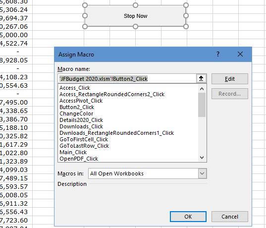

    Sub StopNow()
        On Error Resume Next
        Application.OnTime d, "ChangeColor", , False
    End Sub

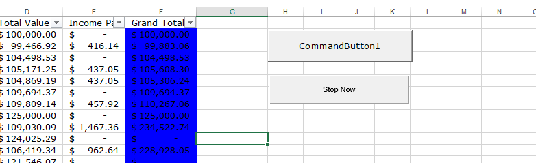

    1. Change the code for the command button (in the worksheet module) as follows:
    Private Sub CommandButton1_Click()
        ChangeColor
    End Sub
    1. Create a Workbook_BeforeClose event procedure in the ThisWorkbook module to stop the scheduling when the workbook is closed. Otherwise, Excel will reopen the workbook after you close it.
    Private Sub Workbook_BeforeClose(Cancel As Boolean)
        StopNow
    End Sub
    1. You may also want to create a command button that executes StopNow, so that the user can end toggling the color.

    Your event is CommandButton1_Click. You don't have a sub named CommandButton1. But we can fix that:
    Insert the code below between the lines
    and
    Dim d As Date
    CommandButton1
    End Sub
    Sub CommandButton1()
    So that your code ends up looking like this:
    CommandButton1
    End Sub
    Dim d As Date
    End Sub
    Then everything should work fine

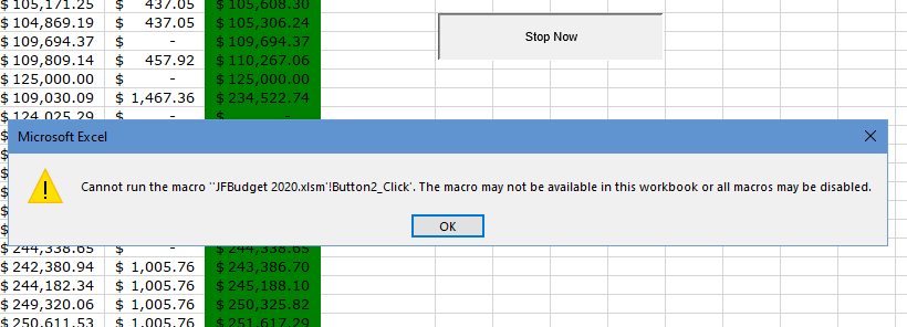

    Hi Hans I inserted in module 3 your code and I did assign it to my CommandButton1 it works perfectly
    but it does not stop. I created a command button Stop Now
    When I right on Stop Button and assign "Button2_Click
    It does not stop blinking
    2020-02-24T21:21:09+00:00
    When I run the Stop button in Module 4. Module 3 refers to your code
