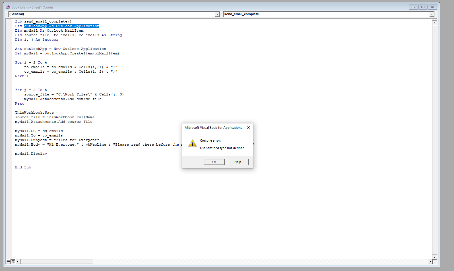

However, when I try to run this macro in my own excel file, it comes with the following error:
Does anybody here have any idea how I can fix this or provide a better solution to my problem? It would truly be much appreciated!

    Hi, I'm Elise, an independent advisor and I'd be happy to help with your issue.
    It looks like you are missing a reference for the Outlook library, can you follow these steps to add:
    In the Visual Basic Editor, on the Tools menu, click References.
    Click to select the Microsoft Outlook 15.0 Object Library check box, and then click OK.
    For reference: https://stackoverflow.com/questions/30598768/ge...

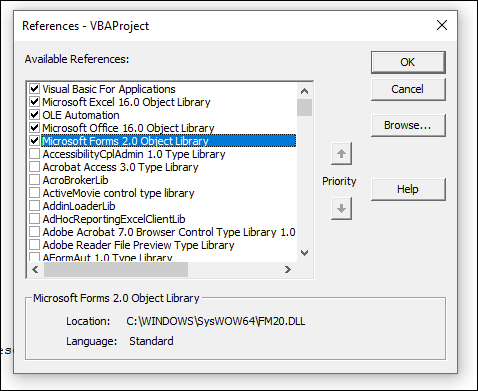

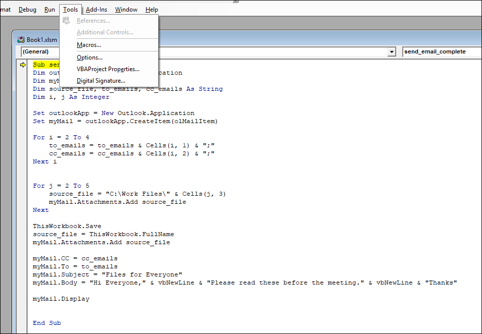

    Thank you so much! However, it seems that my "References" is greyed out for some reason?
    2020-06-25T09:10:52+00:00
    If you press the stop button, to stop debugging it will then activate for you.
    Kind Regards,
    Elise
    2020-06-25T09:17:38+00:00
    Thank you!
    I fixed the references issue, but I can see that I already have Microsoft Office 16.0 Object Library checked out
    Any idea what else I can do?
  5. Anonymous
    2020-06-25T09:52:15+00:00
    Can you try replace that line of code with these instead?
    Dim outlookApp As Object
    Dim myMail As Object
    Set outlookApp = CreateObject("Outlook.application")
    Set myMail = outlookApp.CreateItem(0)
