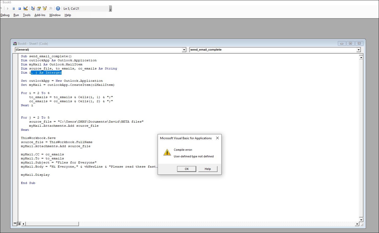

However, when I try to run this macro in my own excel file, it comes with the following error:
Does anybody here have any idea how I can fix this or provide a better solution to my problem? It would truly be much appreciated!

    It didnt work and both if I use my own code or your code it gives me the following error:
    Any idea what I can do? Am I writing the code from the link: https://wellsr.com/vba/2018/excel/excel-vba-send-email-with-attachment/ incorrectly perhaps?
    I am not an expert on this...truly sorry, but I really appreciate your assistance!!

    It looks like the line that is now causing an issue is:
    source_file = "C:\Work Files\" & Cells(j, 3)
    Can you check this actually is a valid file path it is looking up here, so all your files should be in C:\Work Files and your filenames should be in column C

    Hello Elise,
    I put in my source file. However, now I am getting the same error again:

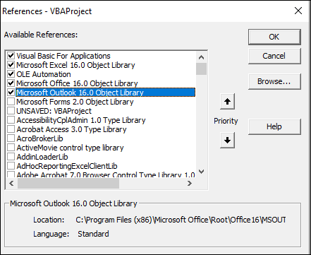

    I have checked microsoft outlook 16.0 in my references
    This is so incredibly confusing... I dont get what I am doing wrong? I copy pasted the entire code from the website and inserted my own source file, surely it should work then??
    2020-06-25T11:38:11+00:00
    It's spelled INTEGER, not INTERGER and you need to declare both types or the i ends up being a variant.
    Dim i as integer, j as integer
    Better as,
    Dim i as long, j as long
    If you do it right, the integer becomes Integer.
    BTW, what happens when you put ?dir "C:\Work Files" & Cells(j, 3) into the VBA editor's Immediate window (Ctrl+G) and tap Enter?
