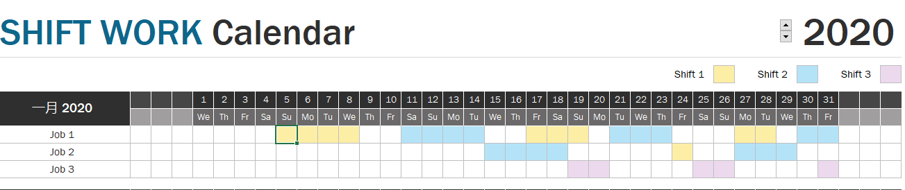

I am loving the Shift Work Calendar template for Excel - it's just what I needed!  I have figured out how to add more "jobs" but I don't know how to create more "shifts".  How do I create a formula to pull through the colors on the shift tracker sheet?

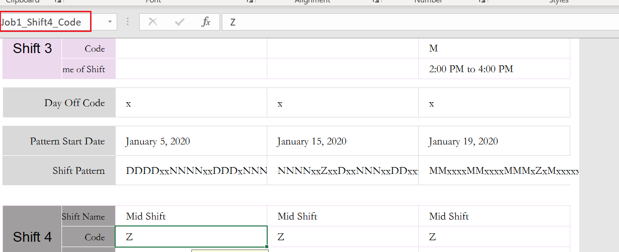

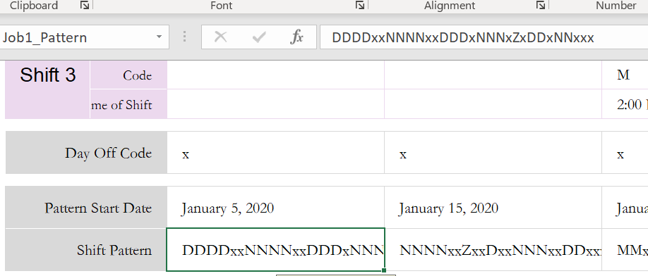

    For Jobs and Shifts sheet, copy/paste a Shift 3 part, name it to Shift 4 as the screenshot. For the “Code” row in Shift 4 part, I type Z as code and rename it as the screenshot. You could also compare the Code row in different Shift parts. Change the Shift Pattern row, I add Z as screenshot 2.

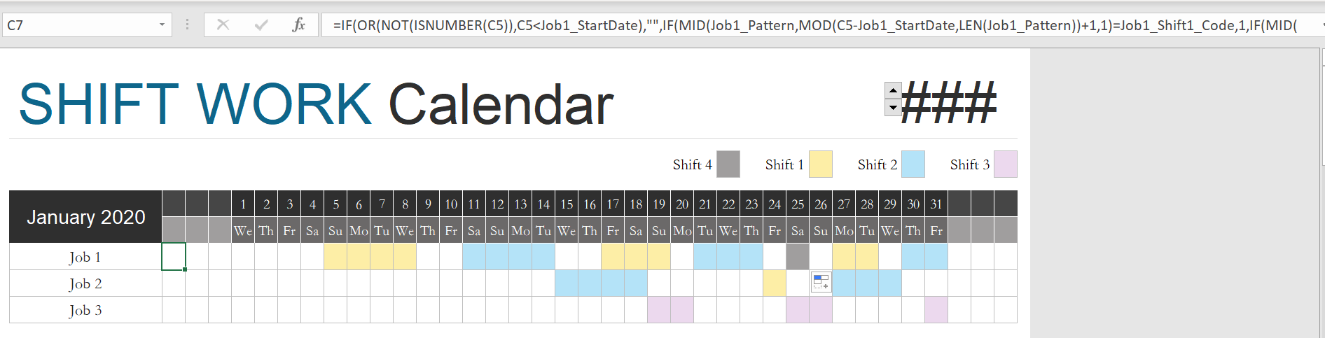

    Step1 set the Conditional Formatting for this new shift
    Select the cell, click Conditional Formatting, choose Format only cells that contain, Cell Value, equal to, =4, choose the color> OK, copy the Applies to from the existing rule, paste it to our new rule, OK
    Step2 change the formula:
    a. Copy the formula in the first date cell as the screenshot.
    Original formula:
    =IF(OR(NOT(ISNUMBER(C5)),C5<Job1_StartDate),"",IF(MID(Job1_Pattern,MOD(C5-Job1_StartDate,LEN(Job1_Pattern))+1,1)=Job1_Shift1_Code,1,IF(MID(Job1_Pattern,MOD(C5-Job1_StartDate,LEN(Job1_Pattern))+1,1)=Job1_Shift2_Code,2,IF(MID(Job1_Pattern,MOD(C5-Job1_StartDate,LEN(Job1_Pattern))+1,1)=Job1_Shift3_Code,3,""))))
    Add the bold part
    =IF(OR(NOT(ISNUMBER(C5)),C5<Job1_StartDate),"",IF(MID(Job1_Pattern,MOD(C5-Job1_StartDate,LEN(Job1_Pattern))+1,1)=Job1_Shift1_Code,1,IF(MID(Job1_Pattern,MOD(C5-Job1_StartDate,LEN(Job1_Pattern))+1,1)=Job1_Shift2_Code,2,IF(MID(Job1_Pattern,MOD(C5-Job1_StartDate,LEN(Job1_Pattern))+1,1)=Job1_Shift3_Code,3,IF(MID(Job1_Pattern,MOD(C5-Job1_StartDate,LEN(Job1_Pattern))+1,1)=Job1_Shift4_Code,4,"")))))
    b. Drag the cell to the same row cell
    Repeat the step b to all the rows, for this sheet, you need to repeat 36 times.

    I have been using the top one - where the months are laid out horizontally.  I am trying to adjust it so that certain "shifts" happen on certain days.  Not all shifts need to happen daily but there are a total of about 5 or 6 different shifts.  Does that make sense?
