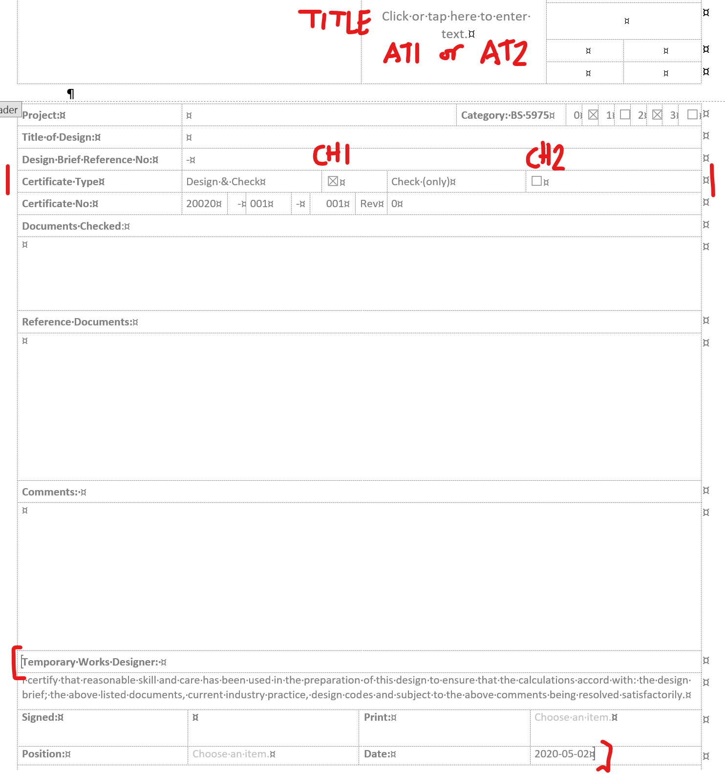

    Many thanks for your comprehensive reply.  Unfortunately I am still struggling .  Do I need to include
    1. I am using Content Controls
    2. document is saved as .docm
    3. AT1 and AT2 saved in Autotect Gallery
    4. check boxes CH1 and CH2 have unique titles and tags
    5. complete row in table containing CH1 & CH2 (enclosed by straight lines).  Do I need to protect more or any at all?
    6. Rich Text Control Content (I guested at this) inserted at 'TITLE' (with title and tag set to TITLE) where AT1 / AT2 text should be inserted
    7. bookmark 'HIDE' enclosed rows in table to be hidden when CH2 is checked
    I not sure if I am defining the position of TITLE correctly using 'Rich Text Control Content' (I suspect not) so the text changes to AT1 (with CH1 checked) and AT2 (with CH2 checked) in the document?
    Also regarding the hidden rows when CH2 is checked.  Where does this part (mentioned in your first reply) of the code go? I had a guest in the code below.

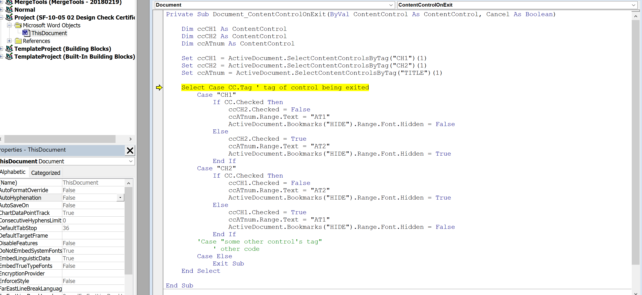

    This is the code as currently entered:-
    Private Sub Document_ContentControlOnExit(ByVal ContentControl As ContentControl, Cancel As Boolean)
        Dim ccCH1 As ContentControl
        Dim ccCH2 As ContentControl
        Dim ccATnum As ContentControl
        Set ccCH1 = ActiveDocument.SelectContentControlsByTag("CH1")(1)
        Set ccCH2 = ActiveDocument.SelectContentControlsByTag("CH2")(1)
        Set ccATnum = ActiveDocument.SelectContentControlsByTag("TITLE")(1)
        Select Case CC.Tag ' tag of control being exited
            Case "CH1"
                If CC.Checked Then
                    ccCH2.Checked = False
                    ccATnum.Range.Text = "AT1"
                    ActiveDocument.Bookmarks("HIDE").Range.Font.Hidden = False
                Else
                    ccCH2.Checked = True
                    ccATnum.Range.Text = "AT2"
                    ActiveDocument.Bookmarks("HIDE").Range.Font.Hidden = True
                End If
            Case "CH2"
                If CC.Checked Then
                    ccCH1.Checked = False
                Else
                    ccCH1.Checked = True
                End If
            'Case "some other control's tag"
                ' other code
            Case Else
                Exit Sub
        End Select
    End Sub

    There are a couple of things to correct -- not too bad for a first try!
    In the first line of the code, make the change indicated in bold:
    to
    Private Sub Document_ContentControlOnExit(ByVal CC As ContentControl, Cancel As Boolean)
    because the variable name CC is used for this in the rest of the macro.

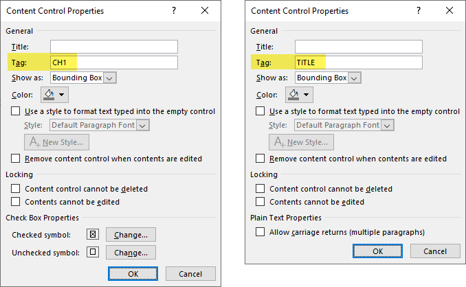

    In the Properties dialogs of the two check box content controls and the content control that you labeled as TITLE, make sure that their names are in the Tag box (the Title box can be left blank) because the code uses the SelectContentControlsByTag function:
    (The Properties dialog of CH2 should be the same as CH1 except for changing "1" to "2".) Also, as shown here, I would recommend using a Plain Text control instead of a Rich Text control. The difference is that a Plain Text control can contain only text, while a Rich Text control can have formatted text, pictures, other content controls, and almost anything you can put into a document. Another thing: There isn't any point in having "AT1" and "AT2" in AutoText; the macro simply puts the appropriate text into the content control.
    You probably don't want the content control's placeholder text ("Click or tap here to enter text") to appear, because users shouldn't be putting their own text there. To remove the placeholder, click the Design Mode button (just above the Properties button). Delete the placeholder text and put in four or five nonbreaking spaces (Ctrl+Shift+spacebar). Click the Design Mode button again to turn it off. The control will appear to be blank until one of the check boxes is checked and the AT number appears.
    If I understand your question in item 5, the answer is that you can group that one line, or more, or none at all. It depends on whether you want to prevent users from altering the text that labels the data boxes (such as "Title of Design") or entering text in boxes that aren't meant to be filled in. As I said earlier, any location that is included in a group but is not inside a content control will not allow typing or formatting. If you do group areas where users should enter things, you must place content controls in those areas so they won't be locked out.
    Grouping is not necessary to enable content controls. (This is different from legacy form fields, which don't work unless the document is protected for filling in fields.) The only purpose of grouping is to prevent changes in areas that need protection.
